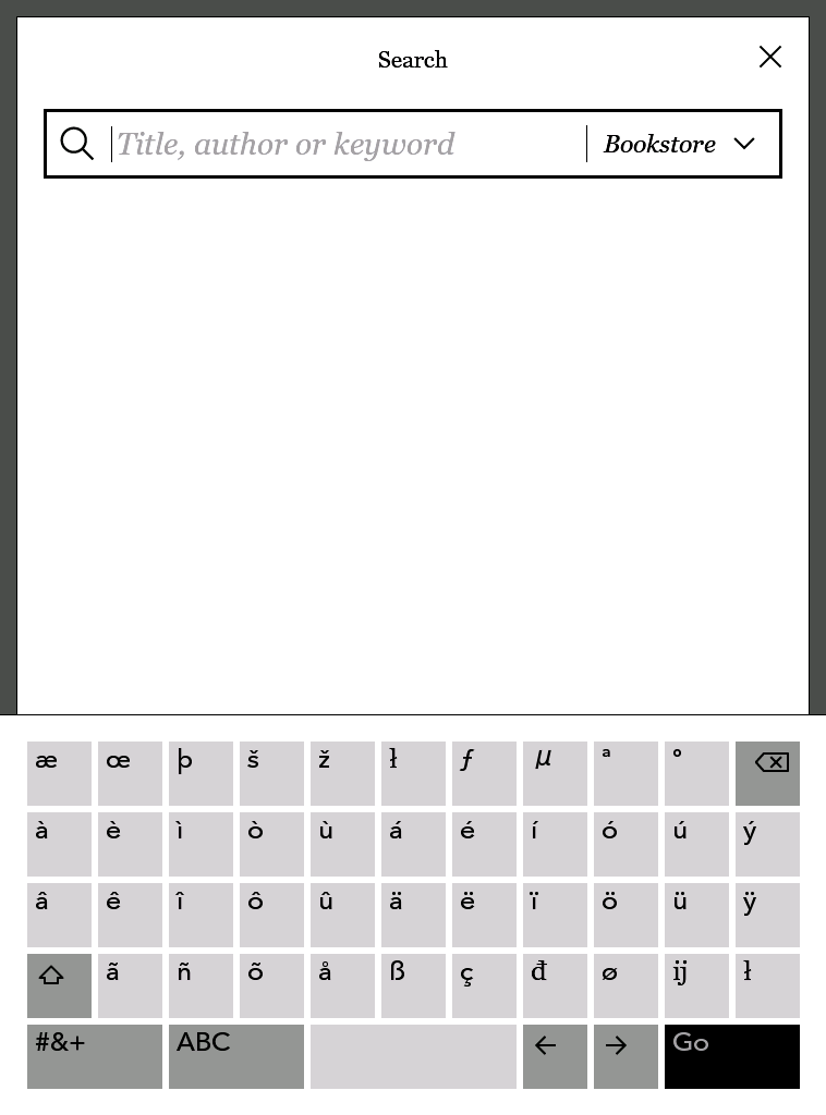

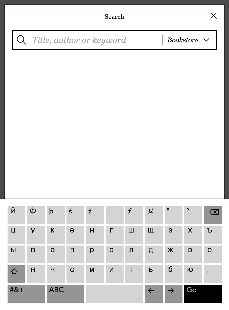

I've tried the Cyrillic keyboard (screenshots attached), but I can't work out how the Cyrillic characters are encoded, so no Idea how to convert to Arabic.

Here is the Cyrillic keyboard patch for an earlier firmware version in the original kpg.exe format:
<Patch>
patch_name = `Cyrillic keyboard`
patch_enable = `no`
# Enable uppercase for [ß] key
replace_bytes = AAF640, 00 24, 01 24
# Replace layout sign
replace_string = 112AAA8, `ÉÀÇ`, `абв`
# Change keyboard layout
replace_utf8chars = 112AE60, `æàèìòùáéíóúý`, `йцукенгшщзхъ`
replace_utf8chars = 112AE90, `œâêîôûäëïöüÿ`, `фывапролджэё`
replace_utf8chars = 112AEC0, `ãñõåßçđøijł`, `ячсмитьбю.`
</Patch>
If someone can replace the Cyrillic characters here with the Arabic ones that should appear in their place, with reference to the screenshots above, then I can probably update the patch for the current firmware.

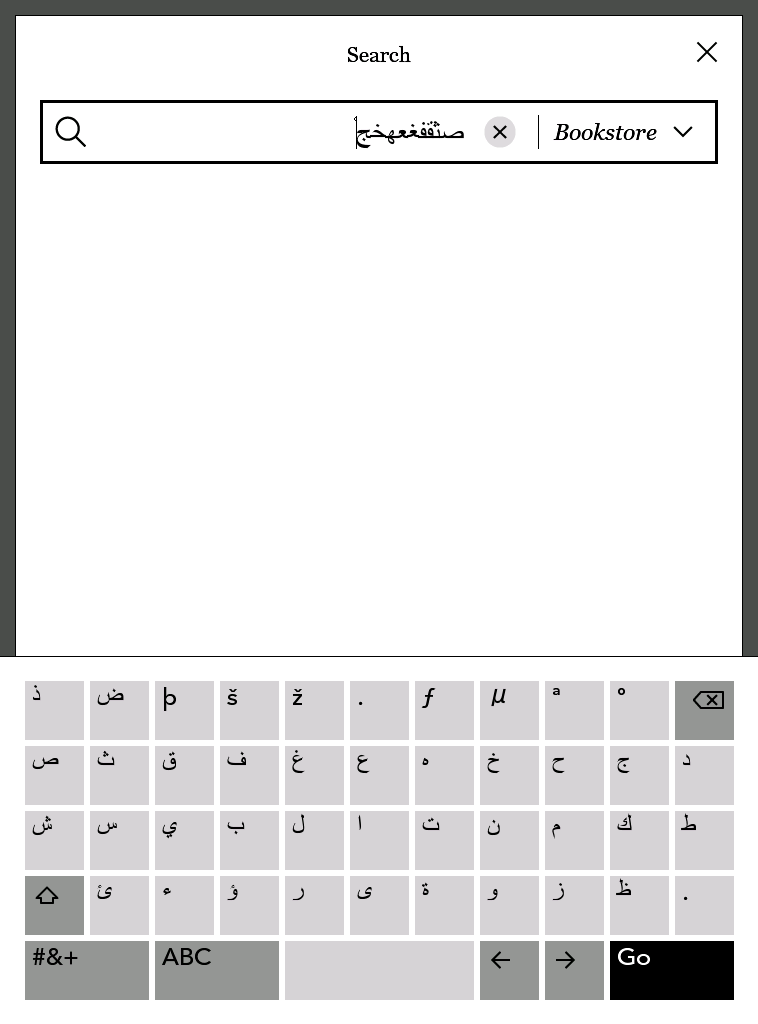

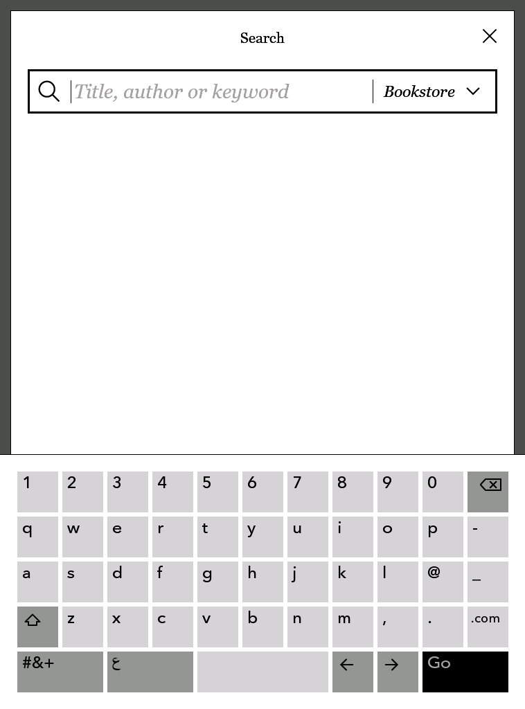

Thanks, I've posted an Arabic keyboard patch for firmware 3.12.1 in the developers forum: https://www.mobileread.com/forums/sho...5&postcount=20.

Thanks a lot GeoffR, it is working great with couple of minor issues, I added more details and answers to your questions on the other thread https://www.mobileread.com/forums/sho...4&postcount=21

I could make a Hebrew keyboard patch too, all I need is someone who knows Hebrew to say where the letters should go, and what the name of the ABC key should be.
The easiest way (for me) might be to look at the screenshot of the QWERTY keyboard in the posts above, and then list each Hebrew unicode character together with the Latin key, e.g. q=א, etc.
The key positions that can easily be changed are:
12
qwertyuiop-
asdfghjkl@_
zxcvbnm,.
