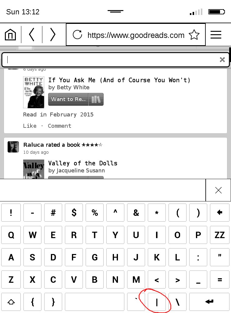

While trying to login @ goodreads I figured that there's no "|" on the keyboard so I couldn't type my password.
Since I didn't find an already made layout that would work I took the EN.kbd and modified it.
I thought of posting it here just in case someone might need it too.
I'm new to PB but I do believe it should work on other devices too.
Usage:
- Just extract it and copy the ZZ.kbd file to system/language/keyboard/
- In your device, select "ZZ: Custom" from Settings > Languages > Keyboard Layouts > Keyboard Layout 1 (or another one if you don't want it as the main keyboard)
- Now when shift is pressed you should have the "|" character (check out the screenshot)
Edit:
Definitely working with other devices. I've tested with PB626 FW5.2. Check the screenshot.
