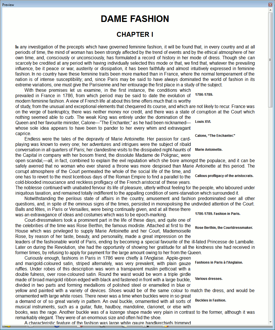

Attached: I exported pages 1-5, just to show you sort of how I would tackle it. I attached two files:
  • EPUB exported directly from Finereader 12: [Chapter1][Export]
  • EPUB that I quickly whipped up: [Chapter1]
Sample of the results: Click image for larger version
If I was converting this book, I would most likely split this into two or three distinct passes:
  1. Handle those color clothing images completely separately, working from the ZIP of images from Archive.org.
  2. Convert the PDF to B/W and focus on JUST the main text (ignore the sidebars)
  3. (Optional) Tackle OCRing all of the sidebars, and manually place them back into the text.
    • If you wanted to tackle these while doing #2, do something like manually making all the text in the sidebars bold + italic. This will help it easily stand out from the rest of the text, so you can easily spot + move + place them.
      • Note: I did this while working in Finereader. I just manually made them bolditalic.
    • The sidebars will just get in the way/clog up/be very annoyingly placed by Finereader, and will just cause you headaches at #2.
      • Note: You can see an example of these <div>s + horrible placement in example: [Chapter1][Export].
    • This step also takes a heck of a lot more time than you expect, because you have to read through the actual text, and determine a new proper location for these sidebars. This WILL cause you lots of headaches.
      • Remember, with reflowability, different font sizes, different page sizes, different device sizes, those floating sidebars won't be placed at their exact locations like in the original. See image above.

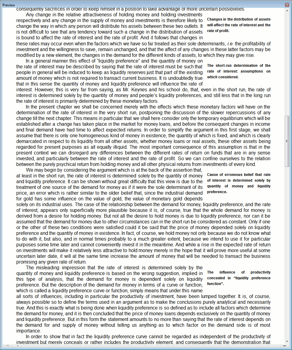

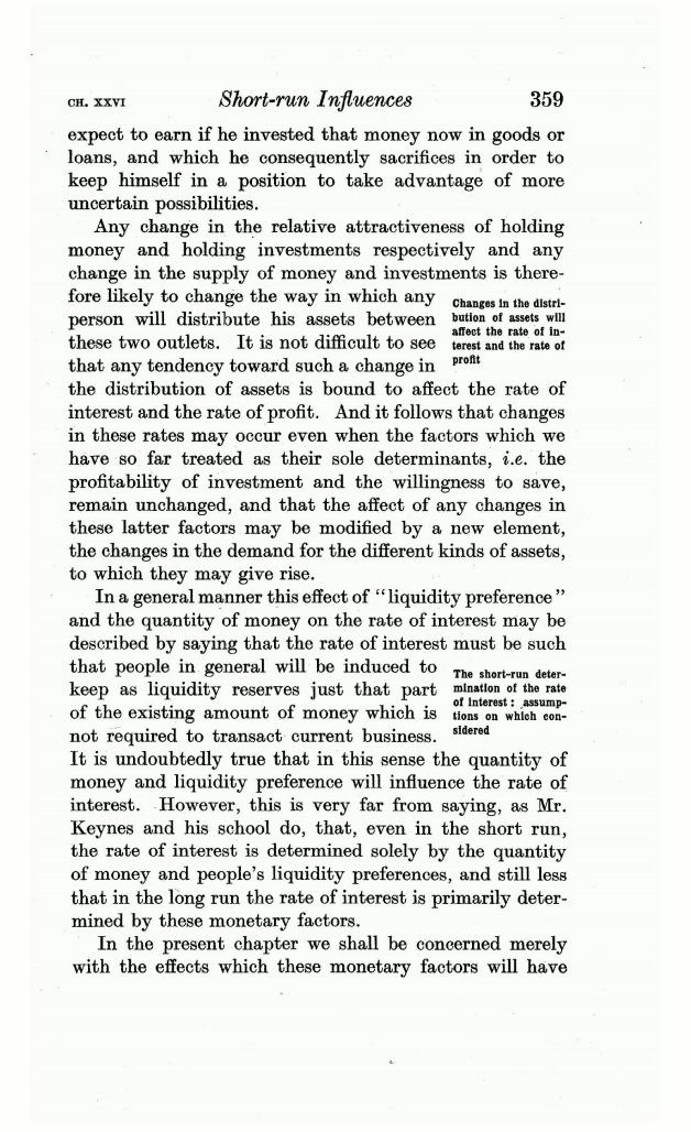

Side Note: I tackled a similar book with many sidebars (although mine was WAY worse, because the sidebars were actually in the main text area. You think YOUR sidebars are causing headaches? ):
ID:	134015 Click image for larger version
Here is the code I ended up settling down on at the time:
 <p><span class="floatright">Changes in the distribution of assets will affect the rate of interest and the rate of profit.</span> Any change in the relative attractiveness of holding money and holding investments respectively and any change in the supply of money and investments is therefore likely to change the way in which any person will distribute his assets between these two outlets. It is not difficult to see that any tendency toward such a change in the distribution of assets is bound to affect the rate of interest and the rate of profit. And it follows that changes in these rates may occur even when the factors which we have so far treated as their sole determinants, <span class="italics">i.e</span>. the profitability of investment and the willingness to save, remain unchanged, and that the affect of any changes in these latter factors may be modified by a new element, the changes in the demand for the different kinds of assets, to which they may give rise.</p>
<p><span class="floatright">The short-run determination of the rate of interest: assumptions on which considered.</span> In a general manner this effect of “liquidity preference” and the quantity of money on the rate of interest may be described by saying that the rate of interest must be such that people in general will be induced to keep as liquidity reserves just that part of the existing amount of money which is not required to transact current business. It is undoubtedly true that in this sense the quantity of money and liquidity preference will influence the rate of interest. However, this is very far from saying, as Mr. Keynes and his school do, that, even in the short run, the rate of interest is determined solely by the quantity of money and people’s liquidity preferences, and still less that in the long run the rate of interest is primarily determined by these monetary factors.</p>
With this CSS:
span.floatright, span.floatleft {
	font-size: 75%;
	font-weight: bold;
	padding-bottom: 15px;
	padding-top: 15px;
	padding-left: 15px;
	padding-right: 0px;
	width: 25%;
	float: right;
	text-indent: 0;
I did this EPUB way back when, and now I would definitely do things slightly differently.
If I had to absolutely keep the sidebars, I would probably touch that CSS up a little (test/make it more robust across devices (this type of sidebar breaks on skinny devices (think cell phone), or when fonts get very large (think poor eyesight)).

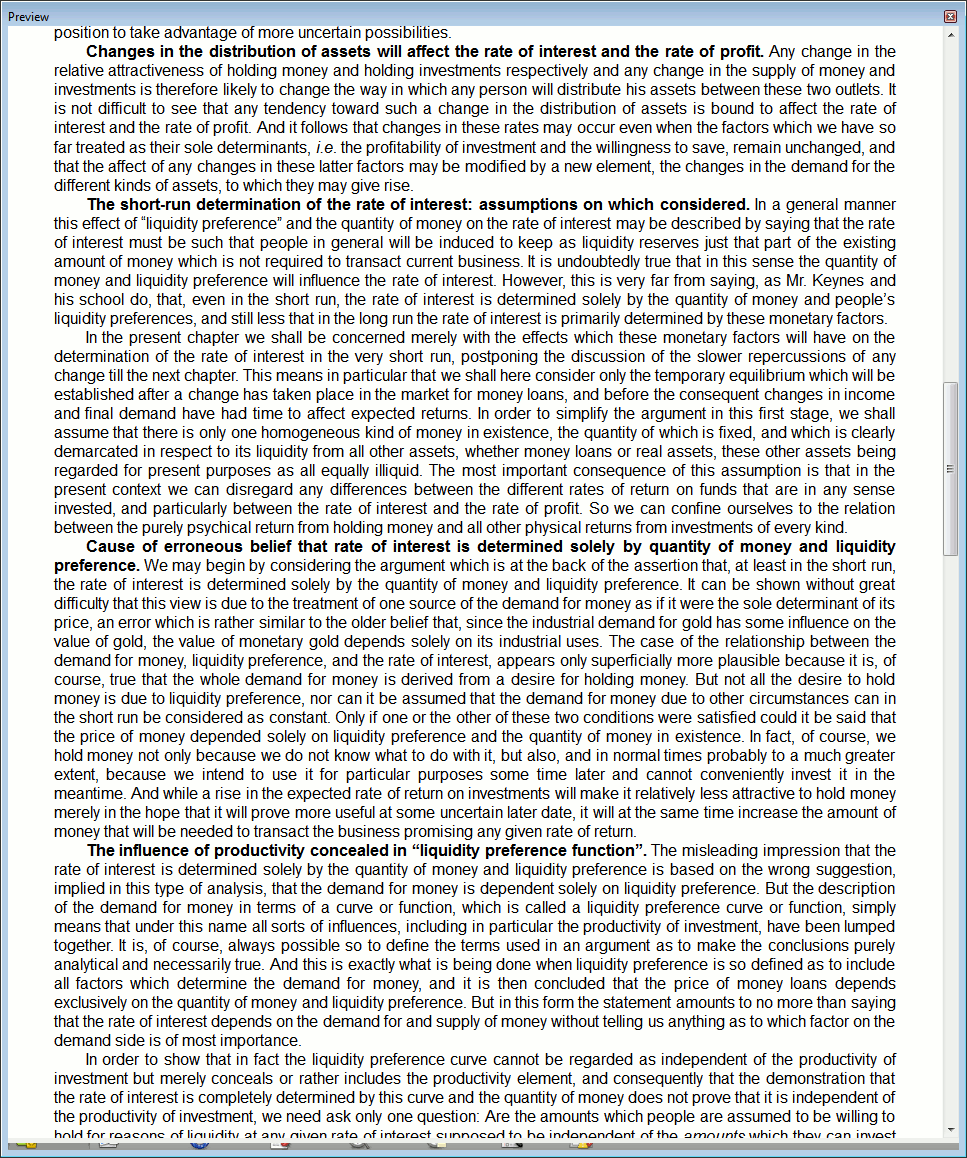

(This is how I handle it now) Most modernized books just avoid the sidebars in this situation, and go with inline. This can easily be done with a simple switch of the CSS:
	font-weight: bold;
This Dame Fashion book has MANY more sidebars though. The books that I have tackled had at max one sidebar per paragraph. This one has multiple per paragraph, and very close together, this would require a lot more thought/condensing on the part of the editor/typographer.
Perhaps converting them into little footnotes? Perhaps coming up with Subchapters covering certain time periods + locations? Perhaps breaking the text into more paragraphs? Perhaps condensing multiple sidebars into one?
Another solution might be to just toss the sidebars out completely. I have also seen that done with many EPUBs.
Also keep in mind, that old school MOBI format (the one on the original Kindle) cannot handle floats. So you will most likely need a still-readable fallback. (Another reason why we eventually settled on the "inline sidebar" solution).
