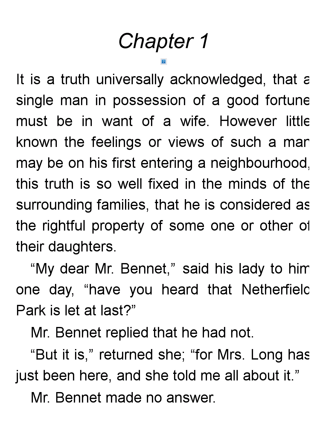

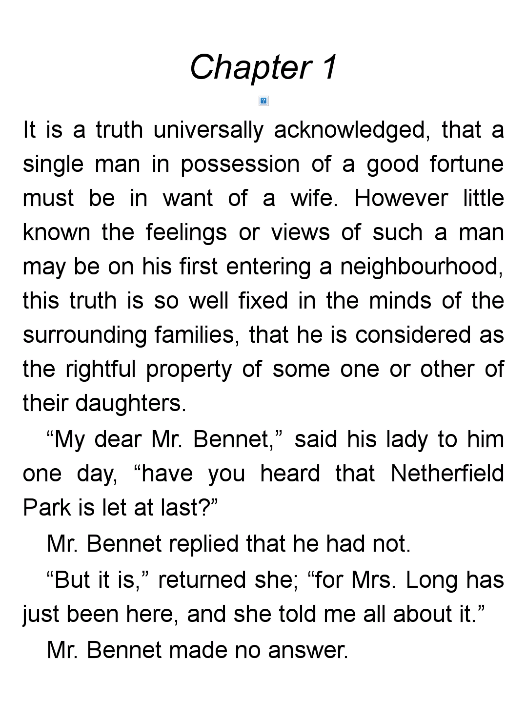

Hi guys, I find if the margin of whole text (body) in CSS is set to 0 like this:
margin: 0 0 0 0
we can get a correct full screen reading without words cut-off.
To modify CSS, the body code section must be known, like this:
<body class="calibre">
          </body>
so the margin setting will be added to "calibre" section in CSS like this:
.calibre {
    display: block;
    font-size: 1em;
    padding-left: 0;
    padding-right: 0;
    text-align: justify;
    margin: 0 0 0 0
and we get the correct display of full screen reading for kepub.
this can be done when kepub is converted by Calibre. it needs to change output setting to prevent Calibre add itself margin. The setting is in Page Setup and you need to set the four margins to zero. Then you can do the conversation.
"f" and "j" issues have been solvedin post #13

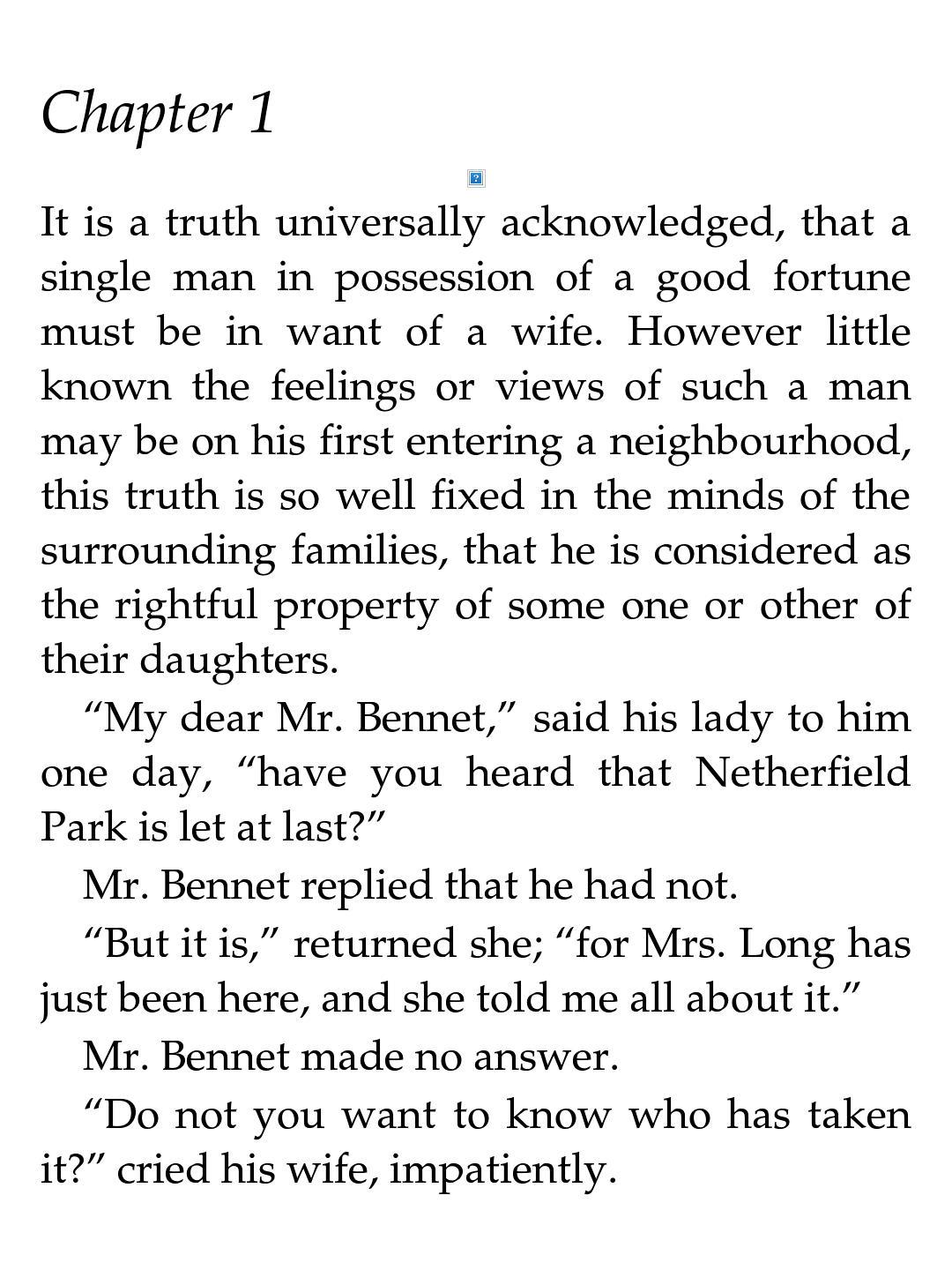

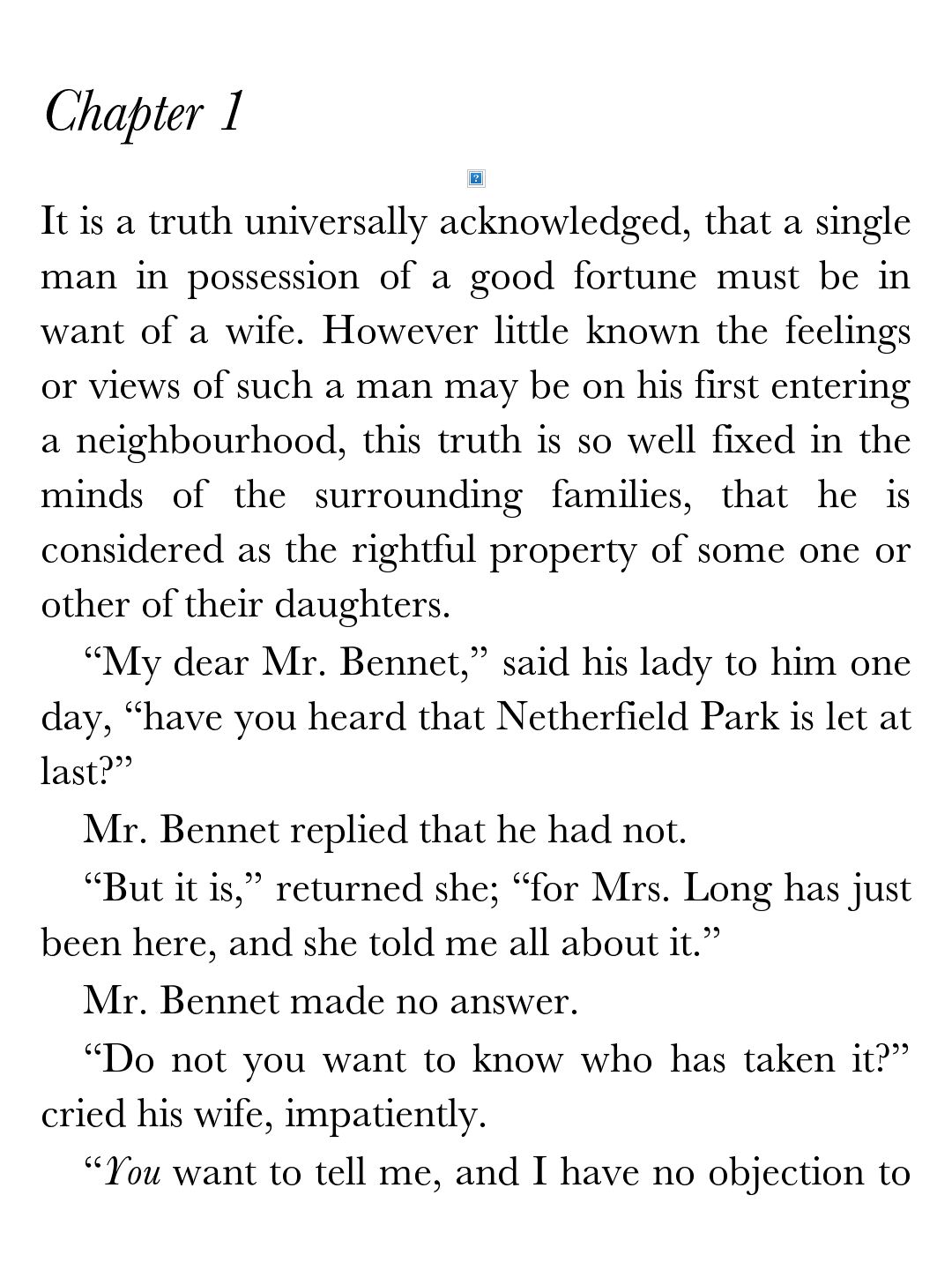

Yes, I find "f" issue and it seems only "f" has this problem.

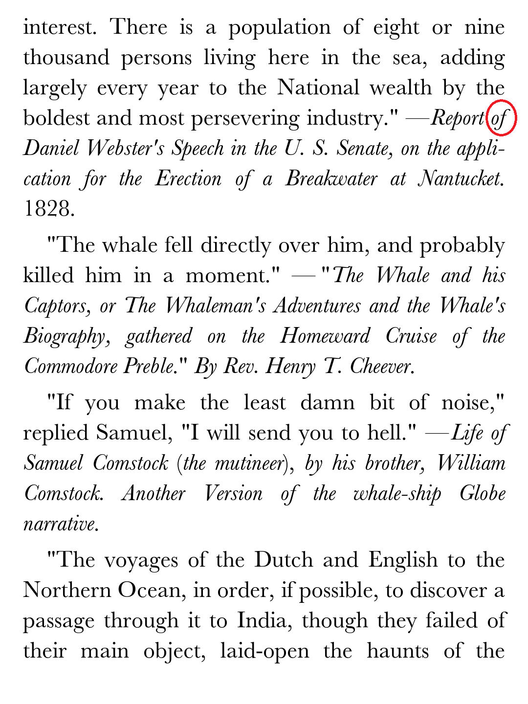

Have a look a the 'f' character at the end of line 8 in your screenshots and compare it to other 'f' characters. The one at the end of the line is cut off at the right.

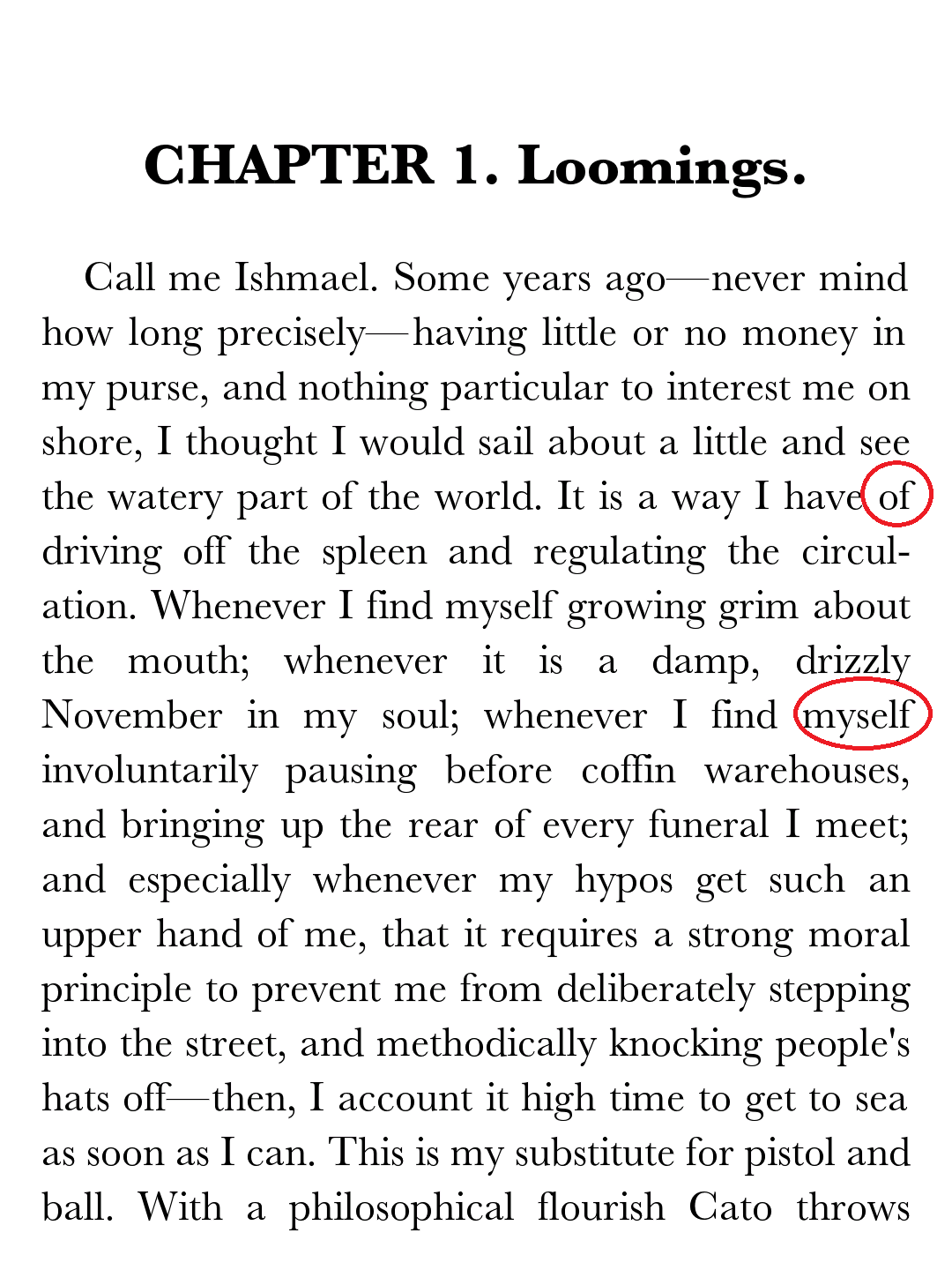

I find in .css there are two section to control the real margin. The first one is mentioned above, it is body section to control whole margin and it is better to set to zero. The second is the detail text section in paragraph, it is better to set to a very small value. To process CSS like this, the "f" and "j" issue will be disappeared.
Example: this code is in html of kepub
<body>
<p>&nbsp;</p>
</body>
The body section in .css will be added with margin: 0;. The p section in .css will be modified like this: margin: 0.25em;
However, I don't find any setting in Calibre can modified this automatically.
