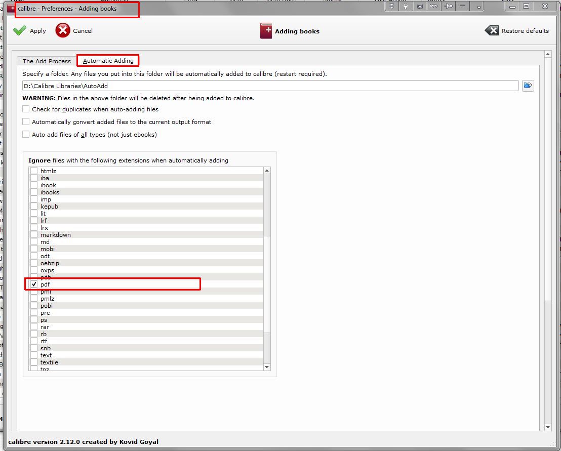

@duytrung - Did the books get added ?
Did you check the ignore list, if a format is ignored then files with that format (file type, extension) are not added to the library, nor are they deleted; i.e. they are ignored - see attachment
