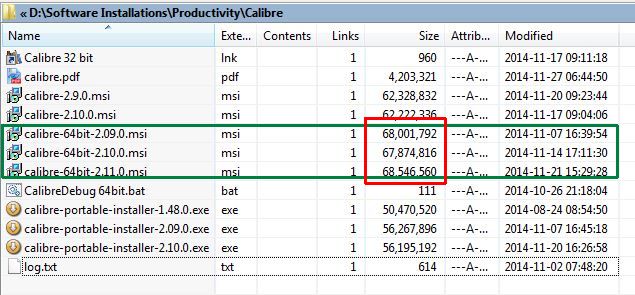

In this case the sizes are not the same
Originally Posted by ArgentSun View Post
So I downloaded 2.11, but when I ran the installer it complained that the file calibre-64bit-2.9.0.msi could not be found in my Downloads folder - which makes sense, I had calibre-64bit-2.11.0.msi in there. Renaming the file seemed to have worked fine (I can launch the Calibre client and it doesn't prompt me to update), but I wanted to bring this to your attention.
That sort of implies you ran the installer from the command line. If so what switches do you use and are you sure you had the right file name.
Why not run the installer via double clicking the .msi file in the downloads folder?

Here's the details of 2.9 and 2.11 as I have them
calibre-64-bit-2-9.0 Revision {8FBC8DFD-FDF6-4E81-8622-65644FD6FCD1}
CRC32	40550977
MD5	f30269bc99c0709ca258afa070c2966b
SHA-1	60b069470f1f6d6df3bc75d6a1fea10dca4b9390
calibre-64-bit-2-11.0 Revision {6342411D-58FD-47E9-B395-5B6ED8B373BB}
CRC32	9cf6cb9d
MD5	ca2790456a05e796527bddc75f6b7066
SHA-1	804e2e95e8a17b5b7ad11c2aeec186e57c2c2a26
You can get Revision numbers in Properties->Details and I use Nirsofts Hashmyfiles for checksums
Whoa - I suspect there was a correction release for 2.11, approx 241 minutes after initial release - the current file size, revision number and hash codes are different.
calibre-64-bit-2-11.0 Revision {8C814D0B-8B4B-415F-BFB1-0523EB6E7844}
CRC32	48fb7005
MD5	ee5dbfb7261fb465067c693df5f5ac1b
SHA-1	e0e9c3f6a5dfce98ddf29645b64d0c3eca2151b9
That's where use of third segment of version number would be useful.

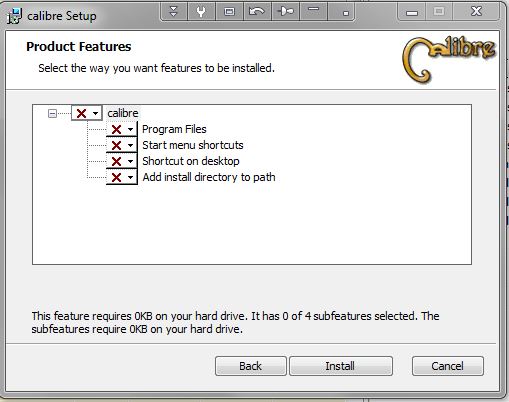

I think I've figured out what was causing the mismatch. When updating to version 2.12 I selected Advanced on the install, primarily to check the location of the install was set correctly; it was. However on the next screen where the options to select the components is, none of the components was selected by default.
By clicking on the top option and selecting "run all from computer", it selects the four options below.
I'm now successfully updated. Hope that helps anyone else having the same issues.
@MetalOllie - thanks for letting us know you figured out what was happening. Are you saying the Features dialogue looked like this:
If so, that's bizarre, because that either means someone did this
Name:	Screenshot - 2014-11-30 , 10_27_15.jpg
or something/one scribbled on the relevant registry values.
I'd never clicked in the top drop down in the features dialogue before now. I wonder if this explains ArgentSun's problem.
By default the 'Trusted Installer' (msiexec) will use the settings from previous installs. If the install on demand option was 'set' msiexec.exe may want to compare the last download with the one being installed, to see if any new features were added or existing ones removed. - hence it was asking for the 2.9.msi.
That's a better rationale for storing the location of the last used .msi file in registry than my previous theory that it was only there to populate the Source column (which isn't normally displayed) of the Programs and Features list
Network and install on demand options are frequently used in corporate environments that manage their desktop environments centrally, often in conjunction with tools such as SMS and Tivoli.

Hi BetterRed..
Yes, that's exactly what the menu looked like. Apologies for not having had the time to screenshot it myself, but hopefully with my info and your screenshots the problem can be resolved.
Cheers!
