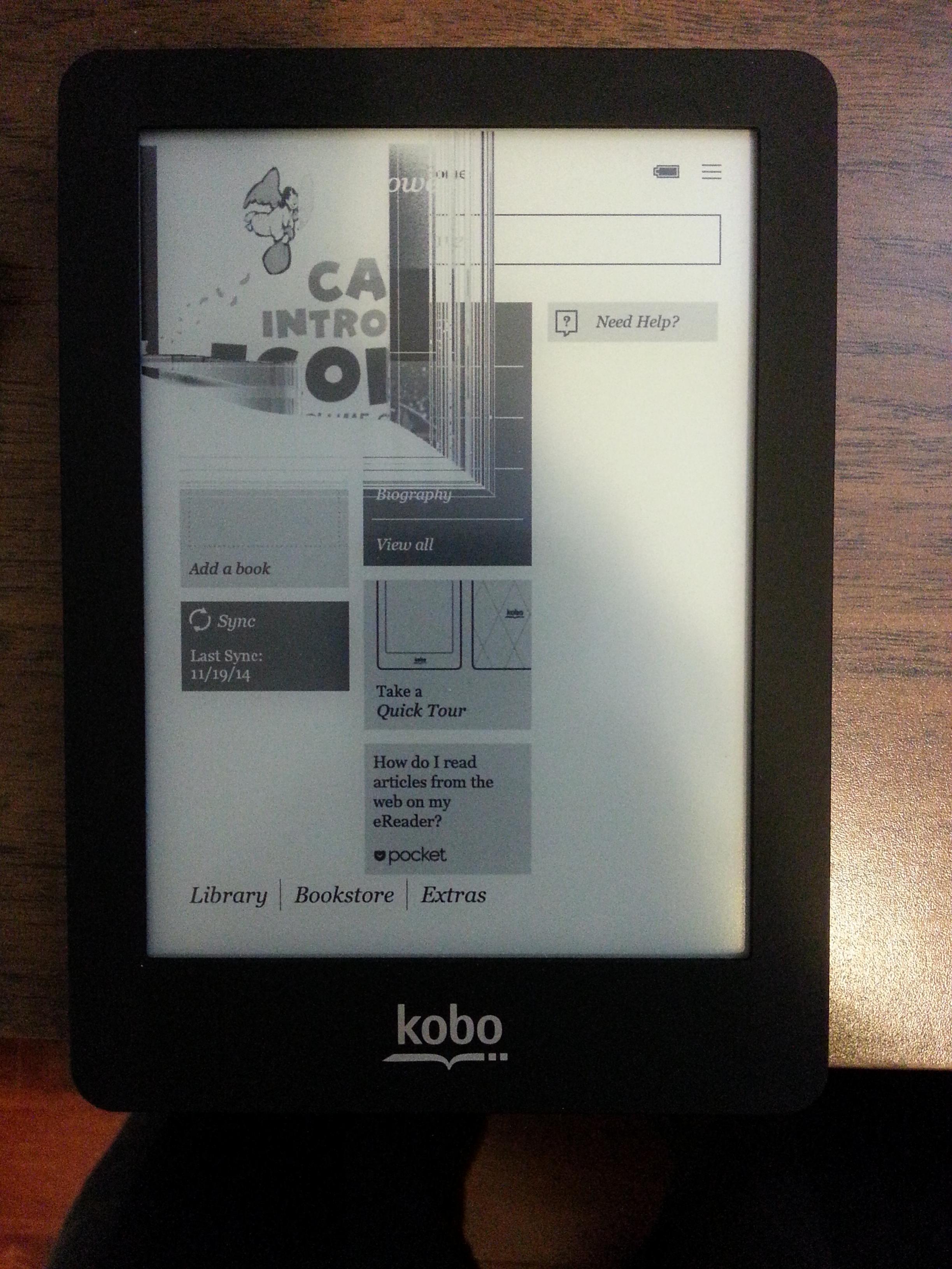

Corner of screen no longer refreshes
The top-left corner of my Glo has suddenly stopped refreshing after starting from a sleep. Neither a soft reset nor a factory reset fixed it. Touch still works as I can still hit the Home icon and I can otherwise navigate normally. Is my screen totally borked?

Yes that seems a broken e-ink substrate... Have you hit/drop your device somehow?

I've dropped it from less than a metre before, but not recently. I was carrying it in a jacket pocket; it was fine just before I left my home. The problem occurred when I took it out on a bus. I don't think I put any undue stress on the device; maybe I sat down a little too hard?
I suppose I don't have any options other than getting a new one.

You have a broken substrate.
There is absolutely nothing you can do to fix it, short of buying another screen and installing it yourself.
Your best bet is to buy another one.

I'm sorry this has happened to you.
The good news (if there is such a thing) is that if you decide to buy another same unit, then you can use the parts from the first one if something goes wrong with the second one AND if the second is out of warranty.
If you decide to get something totally different, you can still sell this damaged one for parts harvesting - there's a market, and someone will buy it as a broken unit.

Don't put your replacement Reader in a pocket and buy a cover for it and always use it with the cover.
Thanks for your suggestion. I did indeed have it in a case; I removed it for the photograph.

My guess is because you had it in your pocket on public transport, that you maybe got bumped. I've read of that sort of thing happening to others.
