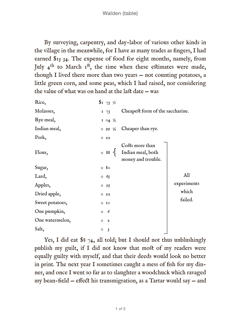

walden-table-ipad.png is a screenshot of this latter epub as it display on the iPad -- basically what I'd expected and hoped for, although apart from other issues (which you'll see with the ADE screenshot, below), I do wish that I could conjure up a way to do up a long (tall), "stretchy" curly bracket (brace), one that would increase/decrease in length (i.e. height) without getting fatter in the process. Any ideas on that one, while I'm here?

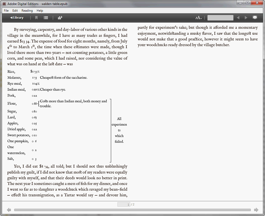

walden-table-ade.png is a screenshot of the same in ADE, which shows the problems I'm having. Obviously, this is far more important for me to get right than it is to do so on the iPad -- although I do find it odd that things displayed as I'd hoped, as I'd coded it, on the latter, but things just go haywire in ADE.
I guess the issues I see with this are...
- How come the widths of my table columns are being ignored in ADE? They should be coming out more nicely spaced (as I'd specified in my code) as they do on the iPad, but it seems like ADE just completely ignores what I set them as.
- How come there's no hyphenation of the word "experiments" in the bottom-right hand column in that table?
- Although you don't see it in this ADE screenshot (in the two-page layout), in a one-page, wider layout the table defaults to aligning itself on the left of the page. Although this is a "bigger" table, I do have a whole bunch of other smaller table to deal with, too, and it would be nice if I could get them all to center (horizontally) in the page -- I just can't seem to figure out how to do so, though! It almost makes me long for ye olden days, when we had the simple <center></center> tag, because text-align:center doesn't cut it.
Right now, I just have no idea what to do about these various tables -- and there's lots of them, and in another book of Thoreau's ("The Maine Woods") I just realized that I'm going to have a TON of them (in the appendix), too.

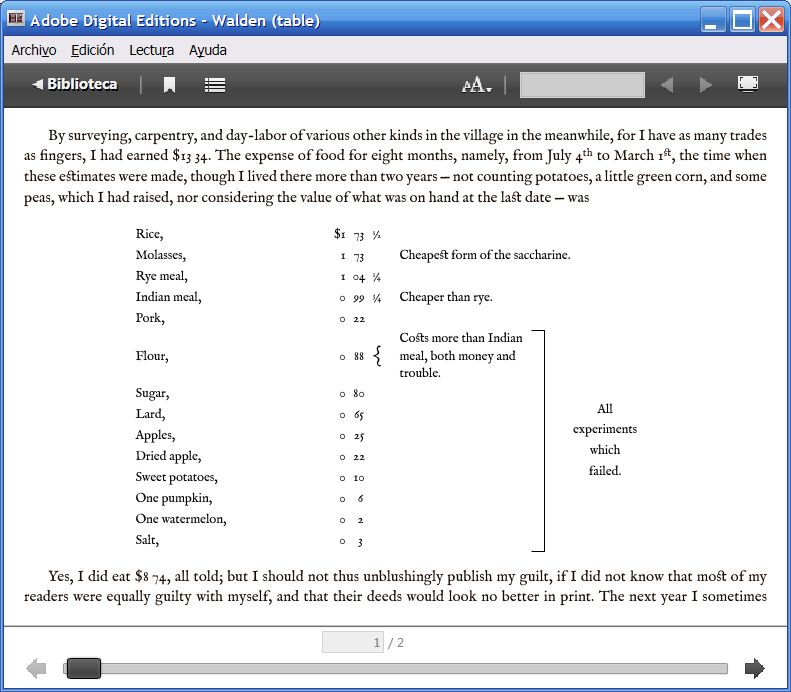

Below you can watch screenshots of my ADE 3.0 (with one and two columns layout):
ID:	131178 Click image for larger version
I hope all this can help you
Regards
Rubén

The problem by using "em" is that -since your tables will have a fixed width- when the left margin increases (because the user changed the font size) then the right side of your tables will exceed your right margin. In other words, you'll reproduce the problem you posted here:

Regarding your new issue with long tables under ADE, could you post an epub with one of those tables?
Except that they don't have a fixed width, I haven't even specified any width at all for the table itself, it just left-aligns to the page, with a 3.2em left margin, and then fills up the right side as much as it needs to. My columns do all add up to "100%", though, but in that regard I don't know how a user changing the font size would make things "overflow" into the right margin, because if it did then naturally that would be happening already -- and it's not. Indeed, just to confirm, I just tried doing what you said, increasing the font size (even to the largest size), both in iBooks and in ADE, and there's no problems at all.
Ok If you don't set a width for your tables, a left margin in "em" can work. But also take in count that in some tables, those ones with many columns, with font sizes big and bigger, the columns of those tables will be thin and thinner and could happen that words appear with "hyphenation" (like the word "experiments" in your first post).
Yeah, I understand that, but I guess there really isn't all that much alternative, is there? I mean, even if I didn't have that 3.2em margin at all, if it was just flush ("0") with no margins on either side, naturally the same sort of thing could happen if the user is going to increase the font size THAT big.
And I am actually quite happy with how this has all turned out. I do have to go over and re-do all my tables (to some extent), one-by-one, but in the process I've discovered some other ways that I can simplify everything, too, and so overall those tables will be much nicer (both in how they display, as well as "behind-the-scenes" for me to work with in coding them).
Thanks again, Rubén -- and I do appreciate your concerns, too!
