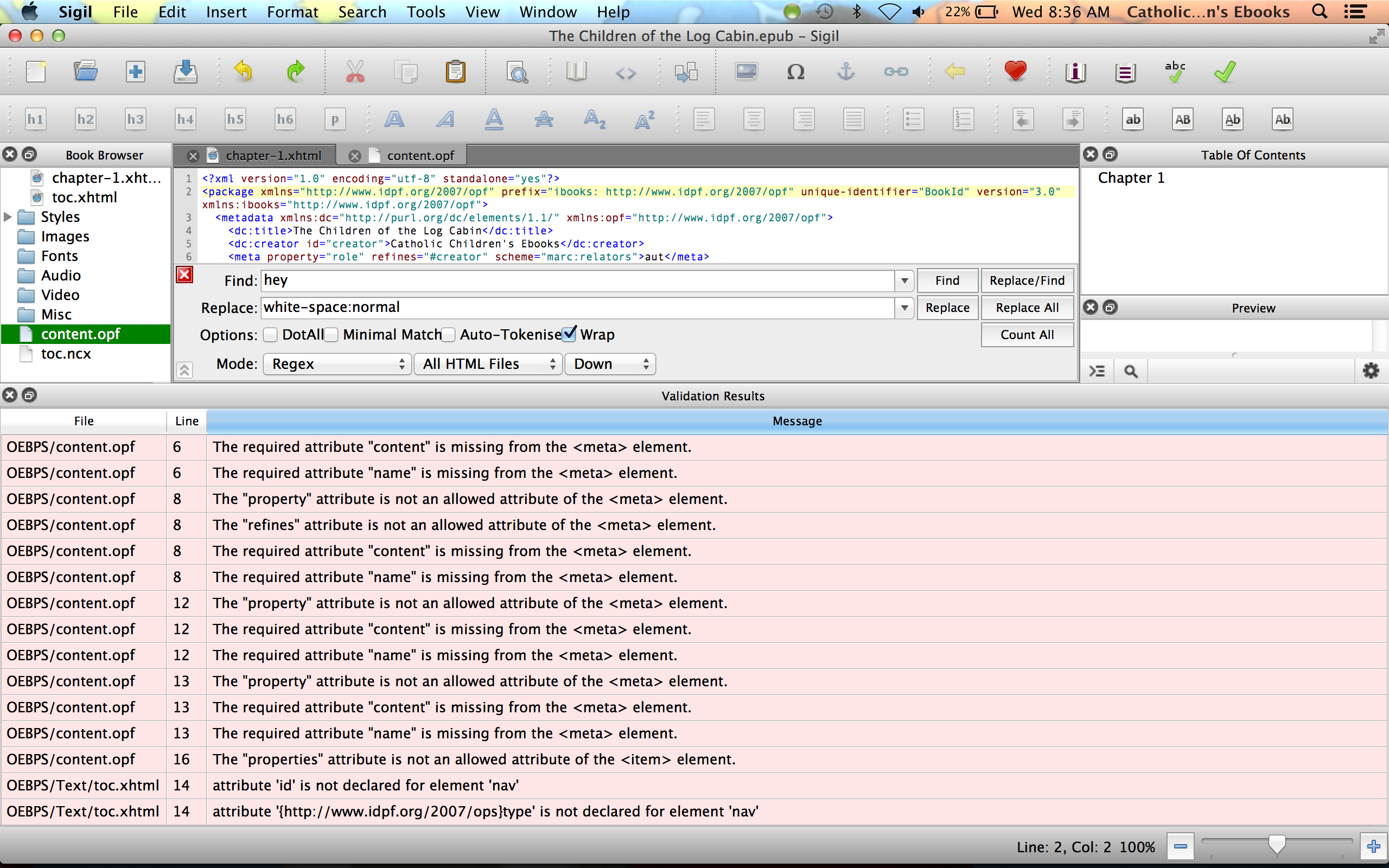

screen shot of errors from pages 5 epub export
Screen shot of some of the errors. Let me know what you think.
The same file, if I export to pages 4 first and then save as epub, there are no errors.
I think Pages 5 exports as ePub3. Unless there are settings within Pages 5 that let you choose ePub2, the output just isn't going to be compatible with any current versions of Sigil (not without a lot of manual fixing anyway).

Yup, that is ePUB3 alright. I sure hope that Pages has that export ability, since a lot (and I mean a lot) of readers out there will not support this. Only few reading programs will support it. One is of course iBooks although they only support their own flavor of ePUB3.
