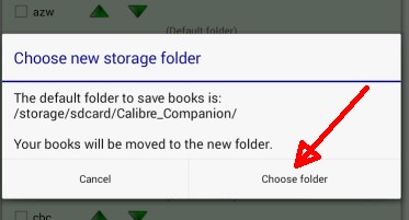

CC does support SD cards on kitkat. It does so without problem as long as you follow Kitkat's rules.
To be honest, I don't understand what problem you are having. When you tap on CC's Formats and Folders setting you will see a dialog showing you the default folder and the list of selected extensions. If you tap on the default folder then you will see the following dialog:

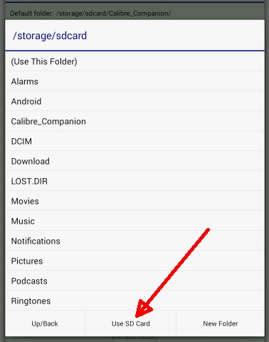

If you tap on the button pointed at by the red arrow you will see the following dialog:
If you tap on Use SD card then CC will choose the kitkat-permitted directory on the SD card.
Have you done this?
Attachment 129384
Attachment 129385
Have you done this?
The problem for me occurs in your 2nd picture. I don't have the middle choice - Use SD card. I only have the two outside choices. I can't type the path in as it makes what I type a subfolder on the internal card. I tried to root the unit earlier using Root Genius but it failed. Thanks for the help.
NetAmigo is offline   Reply With Quote
Then something is broken with your device or your version of android, or you are suffering from something similar to what kaufman described in this post. To be precise, android is telling CC that there is no writable special CC folder on the SD card, so CC does not show that button.
I suggest you try the following:
  1. If you have nothing on the SD card, reformat it and go to step 3.
  2. If you have things on the SD card you don't want to lose, ensure that there is no folder /Android/data/com.multipie.calibreandroid on it. If there is such a folder, delete it.
  3. With the SD card in the device, uninstall and reinstall CC.
I have no idea whether the failed root attempt is causing troubles.
I do know that hundreds of CC users are using SD cards with kitkat, which implies that it works. Of course that doesn't help you, where it doesn't work.
I tried reinstalling CC but it did no good. When you get the middle choice "use SD card", you have not done so with Android 4.4 have you? I assume that you use a prior version.
No. The "use SD card" option appears only if 1) the device is running Android 4.4 or later, and 2) Android reports that an external SD card is available and writable. For Android 4.3 and earlier a different button appears.
There is one possibility that occurred to me while I was looking at the code. Can you put more than one external SD card into your device? If so then CC might be looking at the one that is not installed.
EDIT: before you reinstalled, did you check the SD card for the directory /Android/data/com.multipie.calibreandroid and delete it if it is there? I ask because KitKat enforces user-specific permissions on SD card folders. If the folder was created by a different user, or if the folder was created before a device was reset to factory defaults (which creates a new user), then an app like CC will not be able to write its own folder. This is what kaufman described in his post that I referred to earlier.
