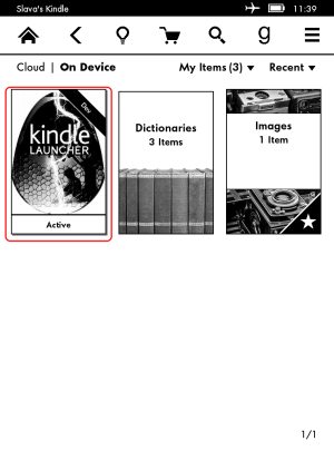

Run the “Kindle launcher” from the main program window.

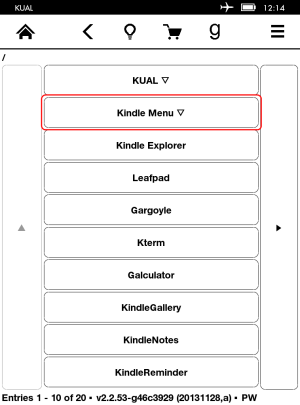

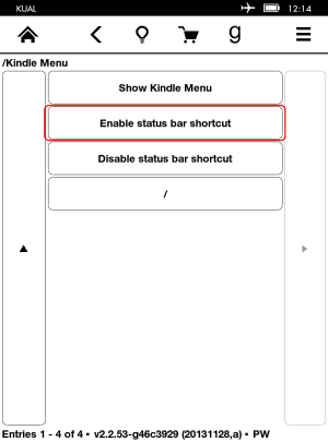

Choose “Kindle Menu” from a list of buttons.

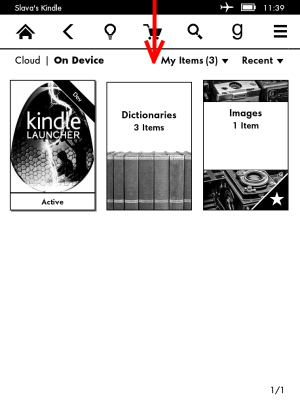

Launch an alternative menu on the side with finger from the top of the screen to the center.
Example of a side from the top of the screen to the center.

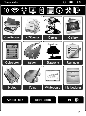

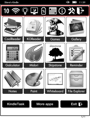

After the side we can see an alternative menu. The line with the quick
launch icons is highlighted in red.
