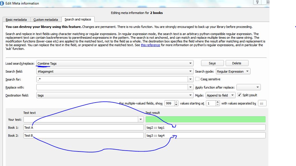

I looked over Search/Replace as mentioned. A previous post answer helped me understand it better. However, I cannot get it to work. I've attached a picture with a test example using 2 books and multiple tags. The goal is to get
  • Book 1: Test A from {#tagsmgmt} to combine into {tags} that already has tags1, tags2; this would yield {tags} tags1, tags2, Test A
  • Book2: Test B from {#tagsmgmt} to combine into {tags} that already has tags3, tags4; this would yield {tags} tags3, tags4, Test B
I see no change in the "test" fields and no change after hitting OK. I've tried with and without the Split checked off. I don't know what else to do. I THINK .* is what's used to pull everything, but I could be wrong.

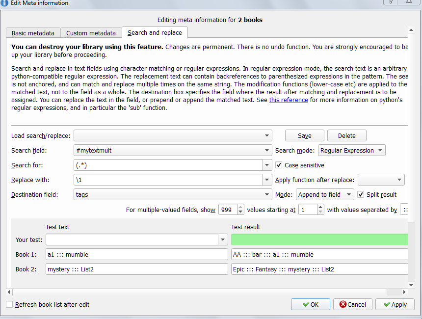

You need to use (.*) in the search expression and \1 in the replace expression. See the attachment.
