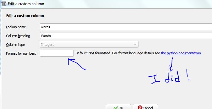

SOLVED - Help with custom column format string to force a comma
UPDATE: Solved as of Post #5.
ORIGINAL POST:
Umm..I DON'T follow all the info on this stuff but I try. I've tried various combinations but only get text of what I try returned in a custom column.
Column is #words which counts words in the book.
Current formatting is simply integer.
I want it to return the number with a comma to indicate the thousands.
I've looked at the info on Format String Syntax and the format() function.
I can't get any combo I've tried to work. It looks like it should be simple, but it ISN'T HAPPENING. I'm feeling like an idiot over this.
Could someone help with this?
Attached is a picture of the custom column window.

Use
{:,d}
The 'd' is optional, but I like it because it documents what kind of number I think it is, in this case integer.

Thank you, @chaley.
Tested and working. That was far simpler than anything I was coming up with!

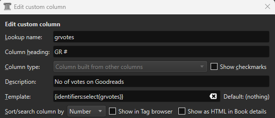

I have a custom column for number of Goodreads ratings. I would like the values to be displayed in comma separated format. I am not able to figure out the template to achieve the same. Here is the image of my column settings:

I was able to solve it with following template:
{identifiers:,d:select(grvotes)}
