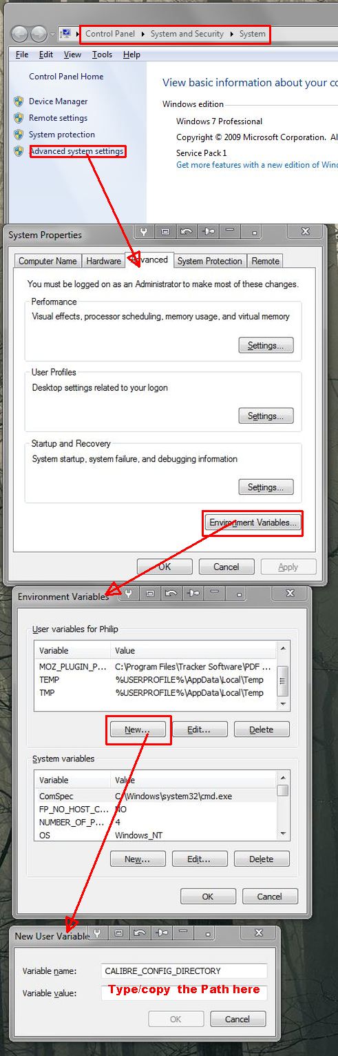

@jecilop - close calibre, copy the existing calibre configuration folder to where you want it to be, rename it if you're inclined, then follow the arrows in the attachment.
The path to the new location must be precise, best to cut & paste from Windows Explorer address bar
Now rename the original calibre configuration folder to say calibresave
Run calibre and go to Prefs->Misc-> and click the Open... button. If it opens at your new location then success, back it up, and then go delete calibresave.

Environment variables are set as per the second link, in the OS. Any running program will inherit all environment variables. calibre will use the value set in that environment variable if available.
If it was to be set from within calibre, then a) it would have to go in the config directory. catch-22 -- which one? and b) the manual would not tell you how to set a system environment variable.

SOLVED!
Thank you @BetterRed. That was EXACTLY what I needed. I didn't realize that I create a "New" one. Now I've connected some of the dots better. I've tested including running some plug-ins just to see.
