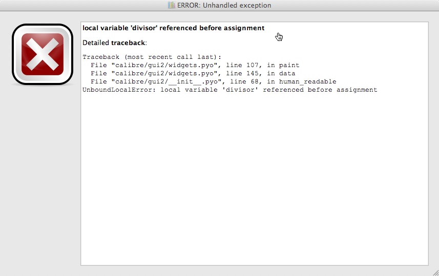

I was running Calibre with no problems on my MacBook Pro until I upgraded to OS X 10.5.3 yesterday. Now when I plug my PRS-505 in while Calibre is running I get the error message in the attached screen shot.
I am still able to access the PRS-505 through the finder window.
Any help would be greatly appreciated.
Carl

Sigh there should be a law against apple releasing upgrades. I'll post a modified build here in a little bit, I don't expect it to solve anything but hopefully it will give a better error message. In the meanwhile, with your 505 connected what does the command
prs500 df
give you.

prs500 df
Filesystem	Size 	Used 	Avail 	Use%
Memory    	210M	-515863572480	492176G	-234090%
Stick     	0	0	0	0%
Card      	483M	-397767278592	379824G	-78447%

Can you try this
http://theory.caltech.edu/~kovid/calibre-0.4.66.dmg

0.4.66 works great!
I tried 0.4.66 and everything seems to work ok. Thanks for the quick bit of help.
Carl
