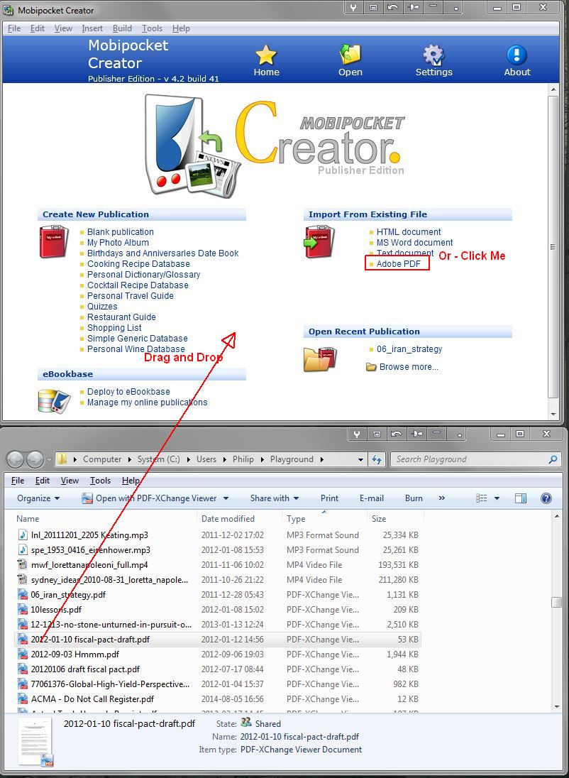

@ittiandro - I use Mobipocket Creator most days of the week to convert PDF to HTML/PRC which I calibre convert to EPUB and or RTF.
Simplest way to use it is: Start program and drag/drop a PDF onto front page, or follow the Import From Existing File->Adobe PDF link on the 'front page'. Don't use the File->Open - that's about creating something from scratch. See attachment.
I have dragged the PDF file into the main screen, as you directed.The import conversion to xml kicks in until about 15% of the process then it stops abruptly with an " import failed" message.
