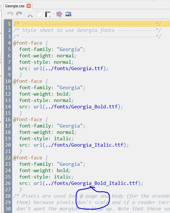

The 'With At' have the @page in the comment on line 28 of Georgia.css
The 'Without At' have a space between the @ and the page in the comment on line 28 of Georgia.css
As far as I can tell, that's the only difference.
Side_by_Side show the Kindle Previewer with Publisher Fonts for both.
Thanks for looking
