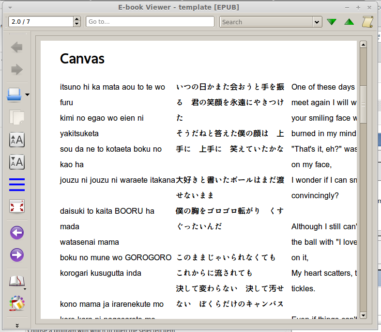

In computer it look like this, (which is perfect)
[Click to enlarge.]

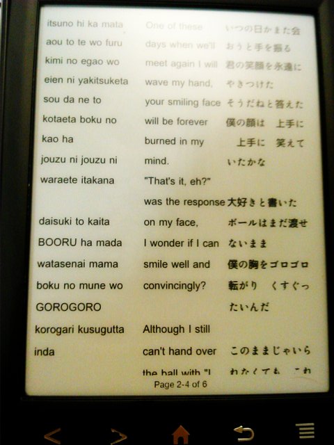

But when it comes to Reader (Sony PRS-T2), it turns to be
So I try,
<div> +
#column1-3 {float: left; width: 33%;}
#column2-3 {float: right; width: 33%}
#column3-3 { float: right; width: 30%; right-margin: 33%;}
The column seems to be all right, but I can't scroll to the content below the screen (just like what happened when using <table>, and I wonder why the <div> tag change their behavior)
[Click to enlarge.]
