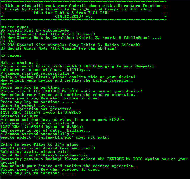

Root failed...
I need some help getting my T68 Lynx rooted I've followed Booxtor guide, but with no luck I've added a print screen.
I've also tried with Towelroot, however as soon as I hit "make it ra1n", it crashes.
Any help would be really appreciated

I think that you are doing the same I did.
When you are asked to make a backup, do you follow the steps shown on your T68?
Because that's what I did wrong...
maybe you have to exit the USB mode in order to see those steps...

Yeah I followed the steps, but it still didn't work, however I downloaded a new file browser and installed Towelroot again, and that time it asked me if I wanted to complete the action with the "Package installer" or "Verify and install" when I chose the latter it worked
Thank you for your help though, really appreciate it.
