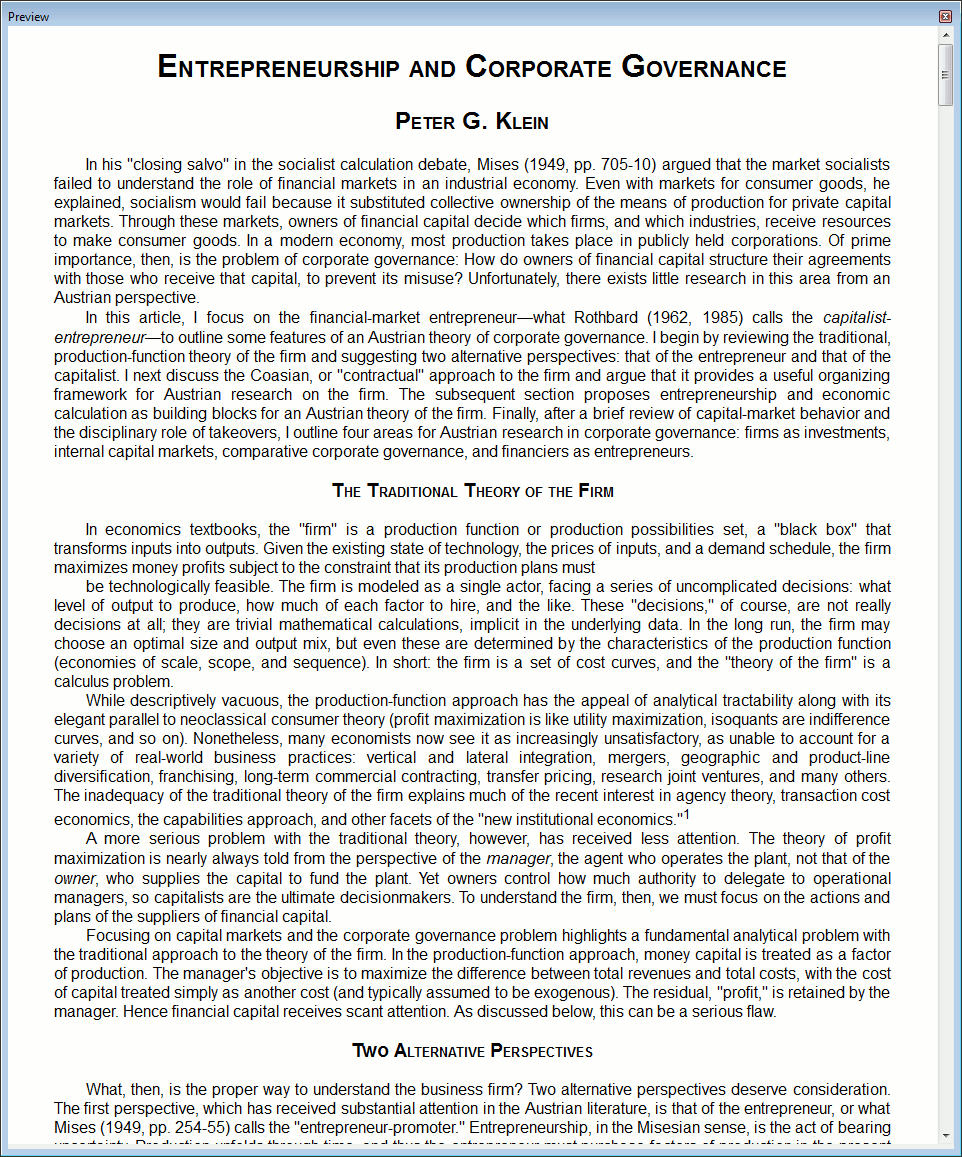

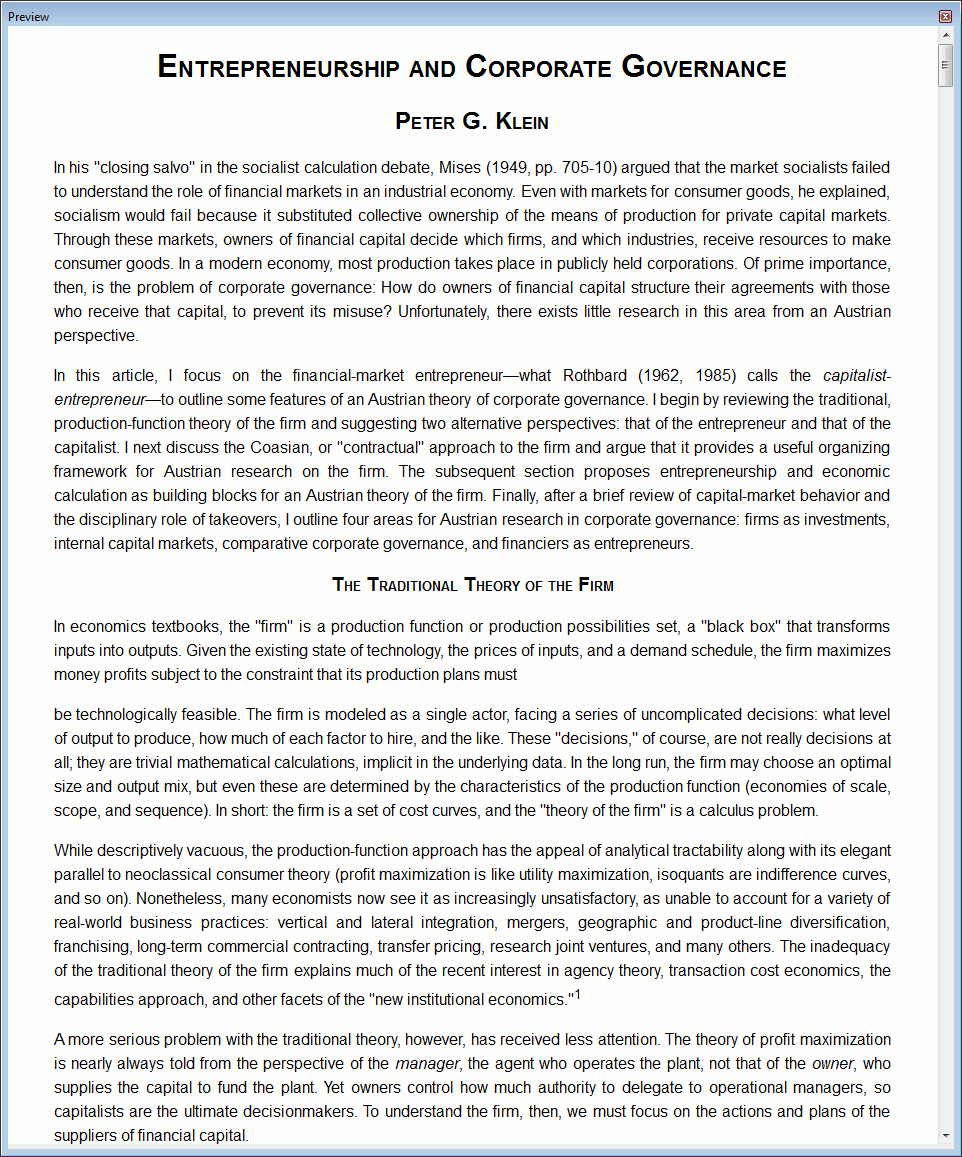

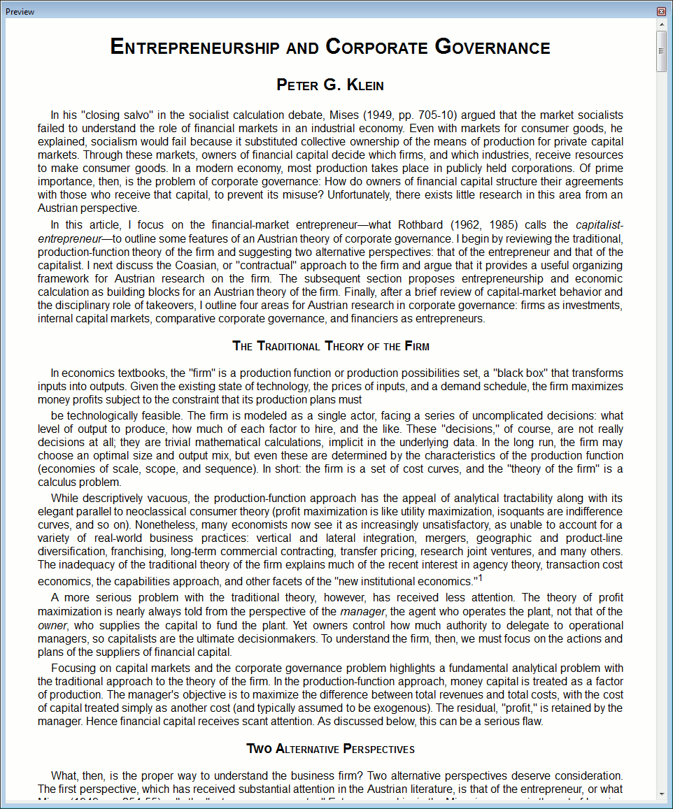

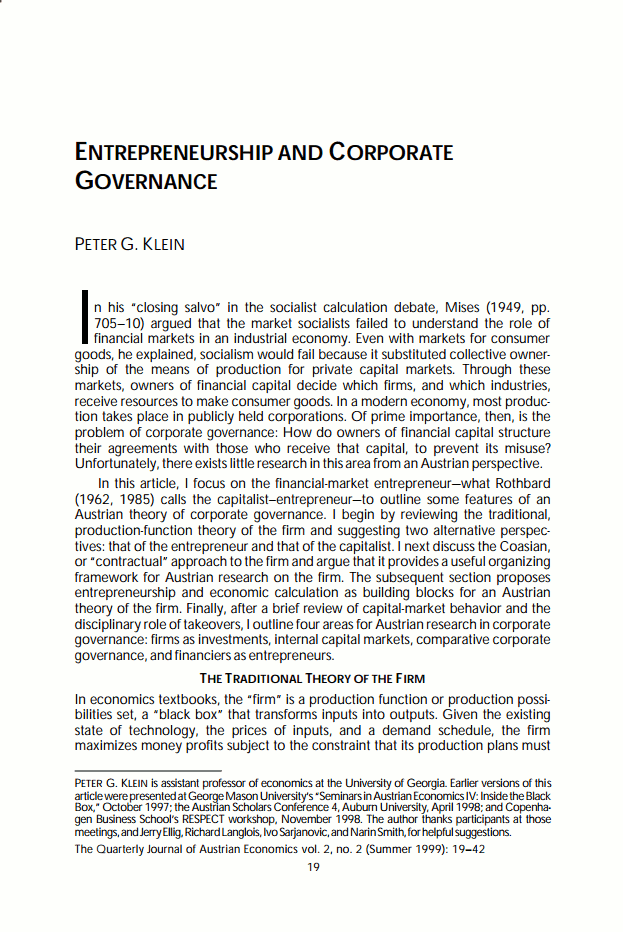

For example, here is a journal I am currently working on digitizing.
Here is a snapshot from the original PDF:
(My personal preference/what I use)
p {
	margin-top: .3em;
	margin-bottom: 0;
	line-height: 1.2em;
	text-align: justify;
	text-indent: 1.2em;
p {
	margin-top: 1em;
	margin-bottom: 0;
	line-height: 1.5em;
	text-indent: 0;
I will defend people's right to hypocritically mangle their eBooks if they want just as it's my right to point out how wrong it is.
