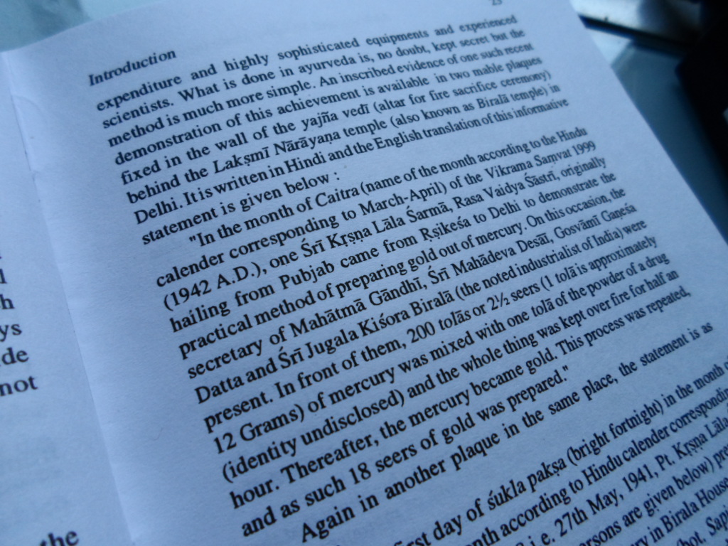

Book has a lot of unusual characters. Possible to OCR?
Without the result being filled with errors. See image.
I would imagine that if it is possible, I'd have to make some significant adjustments to the OCR properties of ABBYY FineReader..

Of course it is possible to do OCR. The results I cannot predict. What you can do, is add a document language. Choose manual and add a new one. Base it on a copy of english and add the additional characters seen in the example. Save it and ensure it is used as well.
No garantuees, but it should work as these characters are now part of the language possibilities according to ABBYY.

It seems to boil down to these types of characters: ā á ã
So a line, an accent, and a tilda. So just add those three things for every single letter and I'm good to go?

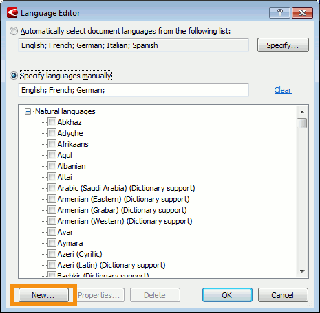

Select "New...":

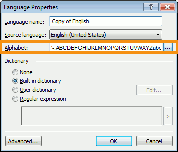

Create a new language based on an existing language:
And under Alphabet, you want to toss in a bunch of the accented characters you see throughout your book at the very end of the list:
Śśāīṛṣ
