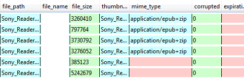

Inspecting the books.db file on T3 revealed that for some reason with all newly uploaded books the correct MIME type string "application/epub+zip" was missing in the database. So the T3 has no idea about the book type. This has no influence for reading the books, however, it just crashes the notes application when you use it. After a crash you can still open the book and by removing the highlight marking everything is then ok again.

  5. but adding books via calibre (USB) results in a books.db afterwards in which field mime-type is empty for all the newely added books, so inspecting the made annotations (at least on the PRS-T2/T3, the T1 does not seems to mind it) result in a crash: "Sorry! The application Reader has stopped unexpectedly. Please try again. Force close."

It is indeed somewhere in the code: see the metadata.calibre contents:
    "timestamp": "2011-04-28T14:41:04+00:00",
    "last_modified": "2014-04-24T13:25:59+00:00",
    "mime": null,
    "authors": [
      "Kovid Goyal"
The reason that it "seems" to work sometimes is when the PRS-Tx recreates the books.db file (by removing the books.db, or via a hard reset), after which all entries are filled with the correct values.
But when you add new books you get the situation as depicted below.
And this is the case for long before the April 18th I mentioned earlier, at least in 2013 as I discovered after inspecting the old metadata.calibre file on my Nexus.

mime has always been null in metadata.calibre that has nothing to do with this problem. In any case, the fix is pretty simple, assuming the mimetype is indeed the cause of the problem: https://github.com/kovidgoyal/calibr...cb0f797f901ddf

Ok, so what is reported in metadata.calibre is different from what is actual written in books.db by calibre.
