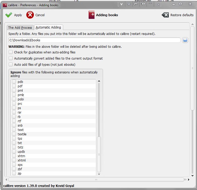

Post a screen shot of the Auto add Settings - here's mine
how long is the path length to the folder, and does it contain any non vanilla ascii characters eg C:/Users/Irène Némirovsky/Documents/... My experience with Calibre is that it's best to keep path names short and simple.

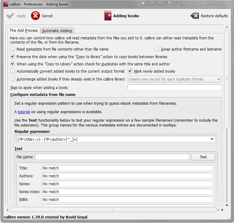

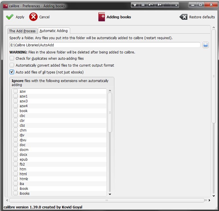

Not sure I can tell you much more. Attached are the Add Books preferences I use on my 'real libraries'. I cant recall how/why I settled on these settings - but they've been working for me for a couple of years.
This morning I put 40+ articles I received over night via mail, nntp and rss into E:\Calibre Libraries\AutoAdd. Within a minute or two of starting calibre they were all in my E:\Calibre Libraries\ReceivingDock library. I do this every morning.
