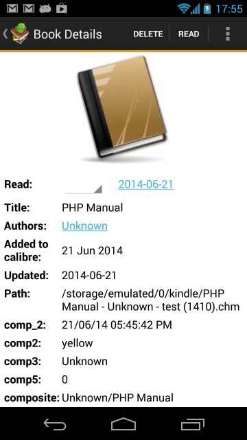

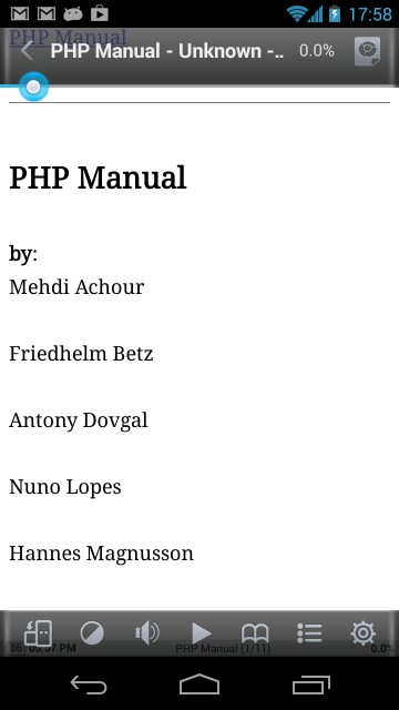

Regarding your problem, CHM works fine for me with CC3.3.5. See the following screenshots:
1) The book details of the PHP manual in CHM, as demonstrated by the path.
2) The result of tapping the Read button.

3) The manual displaying in Moon+
Clearly you are doing something different from me.

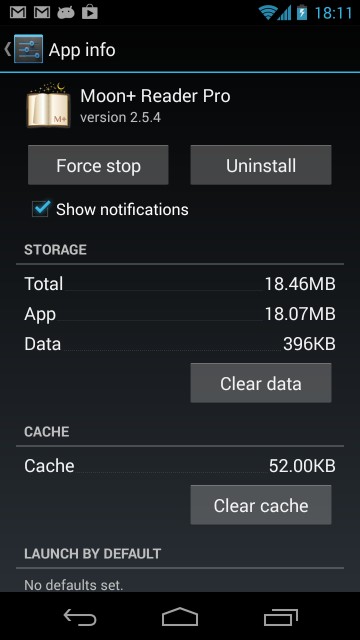

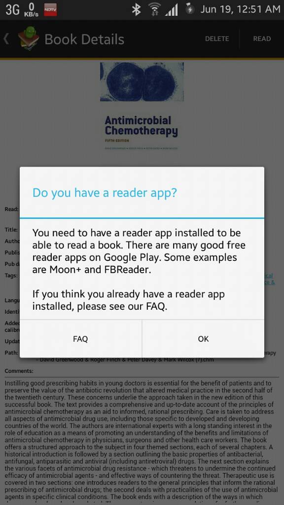

3) Are you really sure you have moon+ pro? Check in Android settings, apps, app info. You should see something like the following:
