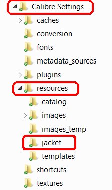

I bet you did change something, you upgraded calibre. If you change the template in calibre's \resources\jacket\ folder it will be overwritten when you update calibre. You need to create an equivalent resources folder (explained here in the manual) in your settings folder add the \resources\jacket\ directory (see attached) and place the modified template there and the template will never be over written.
But I have ! That is what is funny.
Anyhow you are right something must have been changed even if for the life of me I couldn't figure how...
Because I found what was not working and this is it :
you can put a custom column like I described but not in a tag of cbj_tag class. And that's it : I put it in <td> tag and it works.
So I'm giving it as a tip as I had trouble finding how to's about custom column in template.
And I thank you very much for your kind answer, DoctorOhh.
