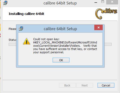

See the attached screenshot for the error during the install. The program did seem to work properly afterwards though. I did update to Win 8.1.1 yesterday, in case it's relevant, because I never encountered this before.

If, as you say, Calibre is working ok I wouldn't worry about it. Windows 8 has a good reputation for sorting issues out for itself.
If it turns out that there is a continuing problem installing Calibre updates and other new applications then it would appear there may a permissions problem to the folder mentioned or the account used. But, for myself, I would not worry about this unless you have an ongoing problem.
But for the sake of good housekeeping and good order, after the new 8.1 update did you reboot the PC before you installed the Calibre update (I know the update reboots the PC 1 or more times itself, but did you take it upon yourself to do another)?
Also, after installing new update to 8.1 did you do another manual check for updates? Depending on the version of 8.1 you will likely get another couple of updates to add to those just installed, their installation being dependant on the existence of the previous ones. I doubt any omission of these would have resulted in the message you got, but mention it just from a housekeeping point of view.

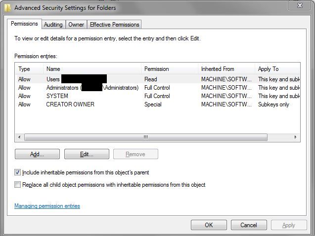

What do the permissions settings look like on that registry key, I've attached mine (Win 7), I don't think this stuff has changed much, if at all.
when you install a Windown [sic] update that does a restart, it does some housekeeping after the restart and the system becomes usable. It's not truly finished until you get the - Updates installed do you want to take a look - notification. Immediately after the Win 7 March patches I tried to install something (not calibre) before that notify popped - it said something like "bugger off - there's another install already running". Was OK after the notify.

...What do the permissions settings look like on that registry key, I've attached mine (Win 7), I don't think this stuff has changed much, if at all.
when you install a Windown [sic] update that does a restart...
Permissions have changed in Win 8, to somewhere between a bit more than "if at all" and a bit less than "quite a lot" . I am on the boat at the moment (no, not fun, been blowing up to 40 knots and pouring with rain ) with only a 32 bit PC, if I get a chance I'll have a look at a 64 bit PC and see what its relevant permissions are when I get home tonight.

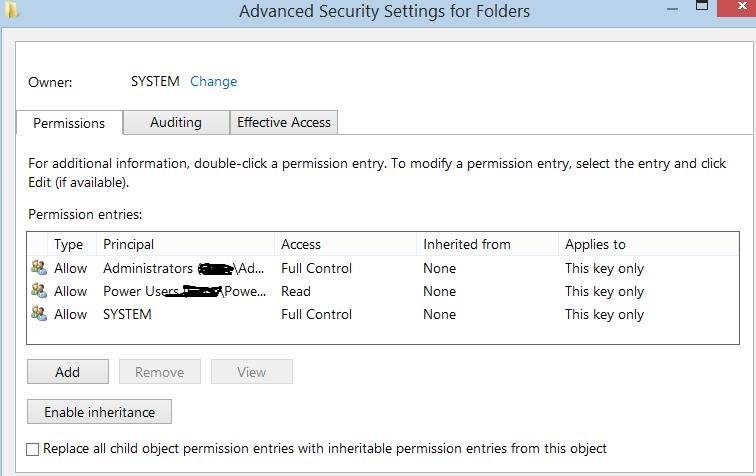

See attachment for what the key looks like here.
Odd that the permissions are not inherited - not that that should make any difference
But otherwise it looks the same, SYSTEM and Admins have Full Control and Users have Read.
The only use calibre makes of the registry relates to un-installing it, and probably reinstalling it. And that's done by the Trusted Installed program, not by calibre itself. I'm not sure what sequence things happen, but I suspect the files are copied first before the registry entries are updated. That Folders key appears to contain a 'composite' index of everything that Windows thinks is in the Program Files and Program Files (X86) folders.
