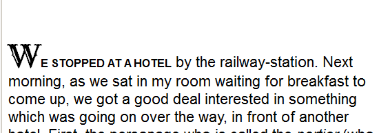

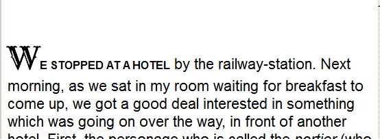

I don't have a Kindle, so if my mutterings are useless, just ignore them.
Just to clarify, you are asking about a Raised / Up cap, not a drop-cap, right?
Drop-caps can be tweaked with both *height* and *line-height*, but it seems like Raised caps only respond to line-height. If this book is only for your own use, you might consider setting the line-height to 120% globally, in body{} or in your p{} paragraph styling. (I know, not an elegant solution.)
The attached screen-shot compares display with default line-height, vs. line-height set to 120 in my paragraph style.
p {
margin: .25em 0;
text-indent: 1.5em;
line-height: 120%;
Maybe one of the gurus will be inspired to find a solution...

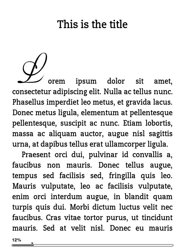

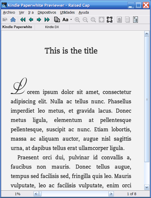

Try this:
1. In your css stylesheet write:
@font-face {
   font-family: "Marnie";
   font-weight: normal;
   font-style: normal;
   src: url("../Fonts/Marnie.ttf");
h1 {
   font-size: 1.4em;
   text-align: center;
   margin-bottom: 2em;
p {
   font-size: 1em;
   text-align: justify;
   text-indent: 0;
p + p {
   text-indent: 1.2em;
.raised_cap {
   float: left;
   font-size: 4em;
   margin-top: -0.75em;  /* play with this value */
   margin-bottom: -0.6em; /* play with this value */
   height: 1em;
2. Write the following in your .xhtml file:
<body>
  <h1>This is the title</h1>
  <p><span class="raised_cap">L</span>orem ipsum dolor sit amet, consectetur adipiscing elit. Nulla ac tellus nunc. Phasellus imperdiet leo metus, et gravida lacus. Donec metus ligula, elementum at pellentesque pellentesque, suscipit ac nunc. Etiam lobortis, massa ac aliquam auctor, augue nisl sagittis urna, at dapibus tellus erat ullamcorper ligula.</p>
In Sigil and ADE doesn't look fine but in Kindle Previewer (AND YOU ARE SEEKING SOMETHING FOR KF8 ) looks very nice (not only for KPW but also for KFHD); watch for yourself:
Of course, you'll have to write some code to manage the old Kindle devices since the code I wrote only works for devices who support the .kf8 format. Below you can see the respective epub.
Regards
Rubén

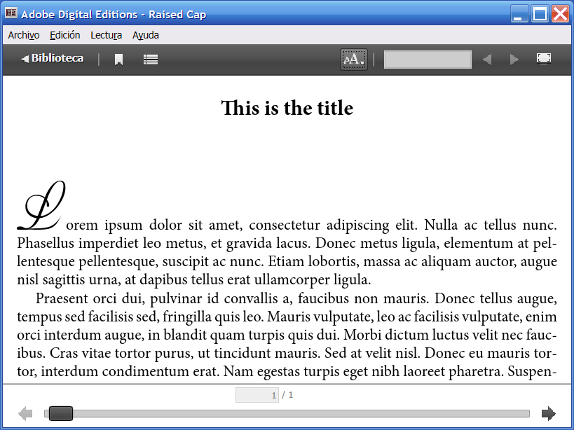

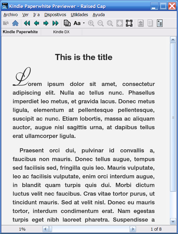

Maybe you could use svg images as raised caps. You'll need to create svg images for each raised caps but are very simple to write them. For example:
1. In the .css stylesheet goes:
h1 {
   font-size: 1.4em;
   text-align: center;
   margin-bottom: 2em;
p {
   font-size: 1em;
   text-indent: 0;
   margin: 0;
p + p {
   text-indent: 1.2em;
2. In the Images folder of Sigil you need to have something like:
<svg version="1.1"
     xmlns="http://www.w3.org/2000/svg"
     width="70" height="90">
    <defs>
       <style type="text/css">
         <![CDATA[
           @font-face {
       </style>
    </defs>
    <text x="0" y="90" style="font-size: 90px" font-family="Marnie">
       L
    </text>
</svg>
I saved the image above as "L.svg". All yours svg images will be the same except that you'll have to change the letter "L" for the letter you want.
3. In your .xhtml file you should have something like:
  <p><img alt="L" src="../Images/L.svg" />orem ipsum dolor sit amet, consectetur adipiscing elit. Nulla ac tellus nunc. Phasellus imperdiet leo metus, et gravida lacus. Donec metus ligula, elementum at pellentesque pellentesque, suscipit ac nunc. Etiam lobortis, massa ac aliquam auctor, augue nisl sagittis urna, at dapibus tellus erat ullamcorper ligula.</p>
This works for .kf8 and also for ADE
ID:	121508 Click image for larger version
However you can get a raised cap in ADE without need a svg image
Finally, a drawback I used as font-size in the svg images "pixel" as unit. That avoids that the raised cap changes its size when you change the device font-size. To achieve that, we would need to set the font-size in the svg images in "em" unit. In theory, svg supports "em" but I never could get that svg accepts "em" So, that is all we have.
Below you can check the respective epub.
Regards
Rubén
EDIT: I forgot to tell you that in Sigil you won't see the custom font in the svg images; that is a bug of Sigil (and some web browser like Firefox). However it will be displayed properly in Kindle.
EDIT II: By remembering a trick that I use with my svg fleurons, I could get that the "svg image raised-cap" changes its size when you change the device font-size. To do this, add the following class to your stylesheet:
.raised_cap {
   display: inline;
   width: auto;
   height: 4em;
and in the .xhtml file use:
  <p><img class="raised_cap" alt="L" src="../Images/L.svg" />orem ipsum dolor sit amet, consectetur adipiscing elit. Nulla ac tellus nunc. Phasellus imperdiet leo metus, et gravida lacus. Donec metus ligula, elementum at pellentesque pellentesque, suscipit ac nunc. Etiam lobortis, massa ac aliquam auctor, augue nisl sagittis urna, at dapibus tellus erat ullamcorper ligula.</p>
Now you have what you want I made the respective changes in the epub attached to this post.

What you see above is a screenshot of my Kindle.
Conclusion: is posible to have raised cap for the .kf8 format. Of course, that will take a bit of time (more than if you could work only with css), but YOU CAN DO IT
Regards
Rubén

Attachment 121901
Regards
Rubén
