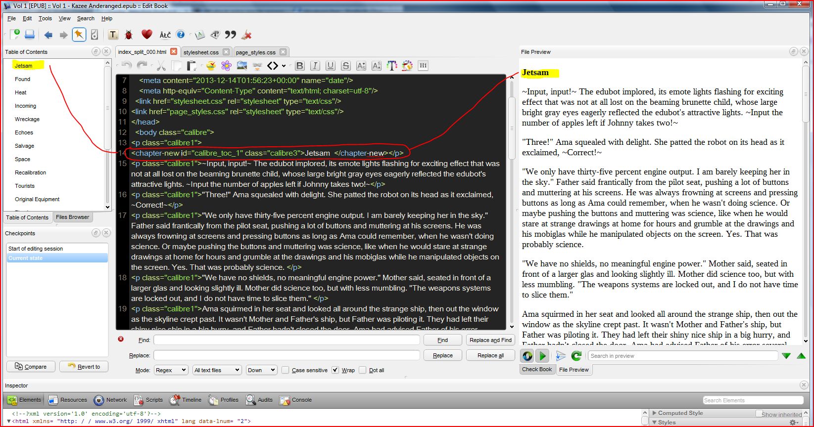

The next step will be the definition of a placeholder for chapter detection, I will call it <chapter-new>. We need this later for the TOC. We defined the regex in three parts and I like to place this <chapter-new> between part one and two. The complete Replacement Text is:
\1<chapter-new>\2\3
Please save this with Save. This was the first part what identity the chapters of the book. The following steps are much faster to do and we will start now with explaining Calibre how to find the chapters for the ToC. You know the added label <chapter-new>.

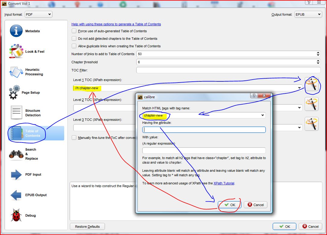

For this, I select the tab Table of Content. The defined tag label <chapter-new> from the first step can be use now for building the ToC with Xpath. I will use the Level one TOC. It is every time a good idea to use the wizard for this (see the blue path). A new window will open and I put <chapter-new> as matching HTML tag name and save it with ok (follow the red path). The Xpath expression for this particular book is:
//h:chapter-new
Please delete all other entries as you can see it in the picture. Now this step is completed and you have a TOC : ).

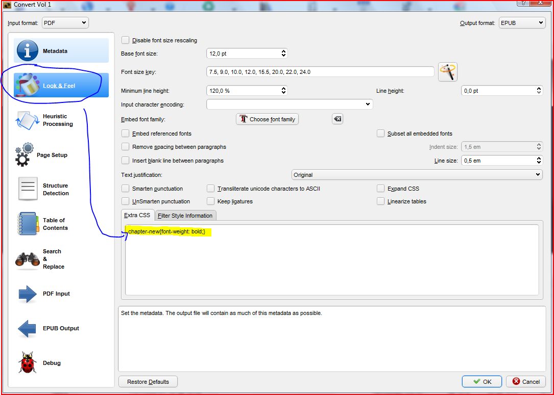

I like to see the chapter of the book in bold (only an example). Moreover, once more I can use the label <chapter-new> for this, because with converting the file, each chapter headline becomes this as tag and I can use it in CSS to give it a style definition. Select Look&Feel. There you will find the section extra CSS and put in for the tag chapter-new:
chapter-new{font-weight: bold;}

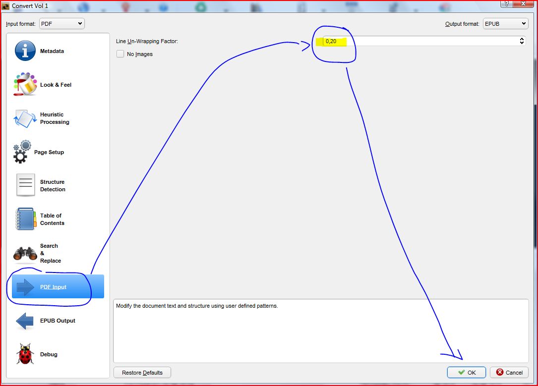

Now to the last step. I guess this is the point where most people are struggling with PDF-Conversion because people do not understand this very well. I am talking about Line un-warping factor. Please select tab PDF-Input. The standard definition for this factor is about 0.45. This is for most PDF-Books to high. I have set it in this example to 0.20. This will help Calibre to get better results for determine a paragraph. This varied from book to book. Play with this parameter.
Now you can do the conversion of your PDF-File and look if it matches to your expectations. One additional hint: You can do a conversion on each step again. If it does not meet your expectation, go back, make an adjustment, and try it once more. Calibre stores the conversion settings for this book.

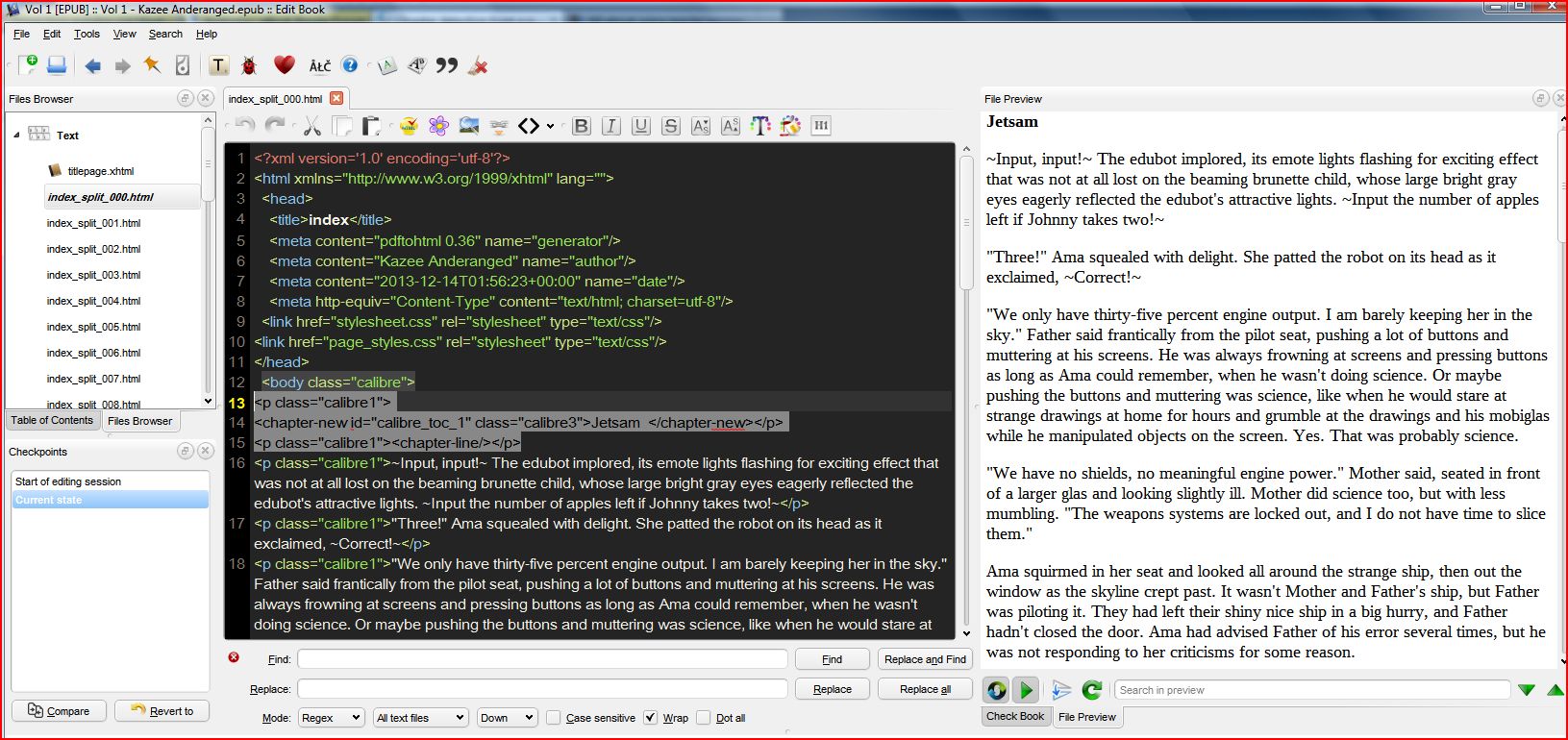

Then you have forgot something in the setup. Take care that heuristic is off and you have clean up all entries the same way. Attached you will find the converted file.
Edit: If you do it the same way I did then you will see this:

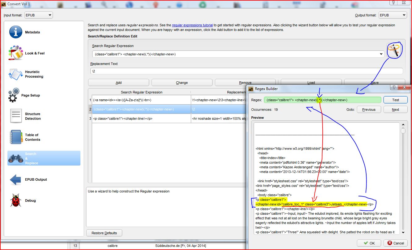

\1<chapter-new>\2\3<chapter-line>\3
See picture Aufzeichnen6 S&R line 1.
Now you can run this conversion first time to look on the results (because you need to define after this the regex for implementing the line). The result is this:
Line 1: <p class="calibre1">
Line 2: <chapter-new id="calibre_toc_1" class="calibre3">Jetsam </chapter-new></p>
Line 3: <p class="calibre1"><chapter-line/></p>
The last line is the line to look at first. This need to be replaced by <hr>. Now I add a second S&R:
Search for: <p class="calibre1"><chapter-line/></p>
Replace with: <hr>
or if you like a bit styling
Replace with: <hr noshade size=1 width=70% align=center>
See picture Aufzeichnen6 S&R line 3. This one and the next S&R will be used later with an EPUB to EPUB conversion.

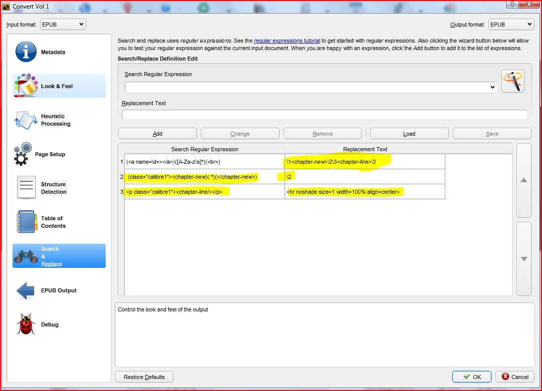

Second one, the formatting issue <chapter-new>:
Well, this is only a help construct and we need to get rid of it in a second conversion. I do not know an other way if you want to do it more or less automatically. The other way is to do it with Calibre editor, as it is simple S&R.
I will use for now the conversion. As you have already seen, there is an overlapping definition for chapters with calibre1 and calibre3 and in addition with the first placeholder <chapter-new>. Therefor I split it in three parts (the first and the last part I like to get rid of, the middle part I need to stay with).
Attention , this is a little tricky because you need to select over two lines for getting the hidden line break. Make a copy past from the wizard, (see picture Aufzeichnen7.jpeg) and select everything from:
class="calibre1">
(Only the beginning p and the ending </p> is not in the selection because this is what will stay) and replace the part
with (.*) and set the rest before and behind in brackets (). Check with test. You need 19 occurrences. If this is ok, take this over and make the S&R complete:
Search for:
(class="calibre1">
<chapter-new)(.*)(</chapter-new>)
Replace with:
\2
Please move this S&R at position 2. (See picture Aufzeichnen6.jpg S&R line 2)
Finally, I made an adjustment for the CSS in Look&Feel:
chapter-new{text-align:center;font-weight:bold;}
and in Structure Detection: Enable Remove first image
Here we are. Everything is prepared. Delete every format excluding the PDF. Then make first the conversion PDF to EPUB (take care of the Line un-warping factor) and then make an EPUB to EPUB conversion.
If it looks like this, then everything went fine und you can do your personal fine-tuning:
