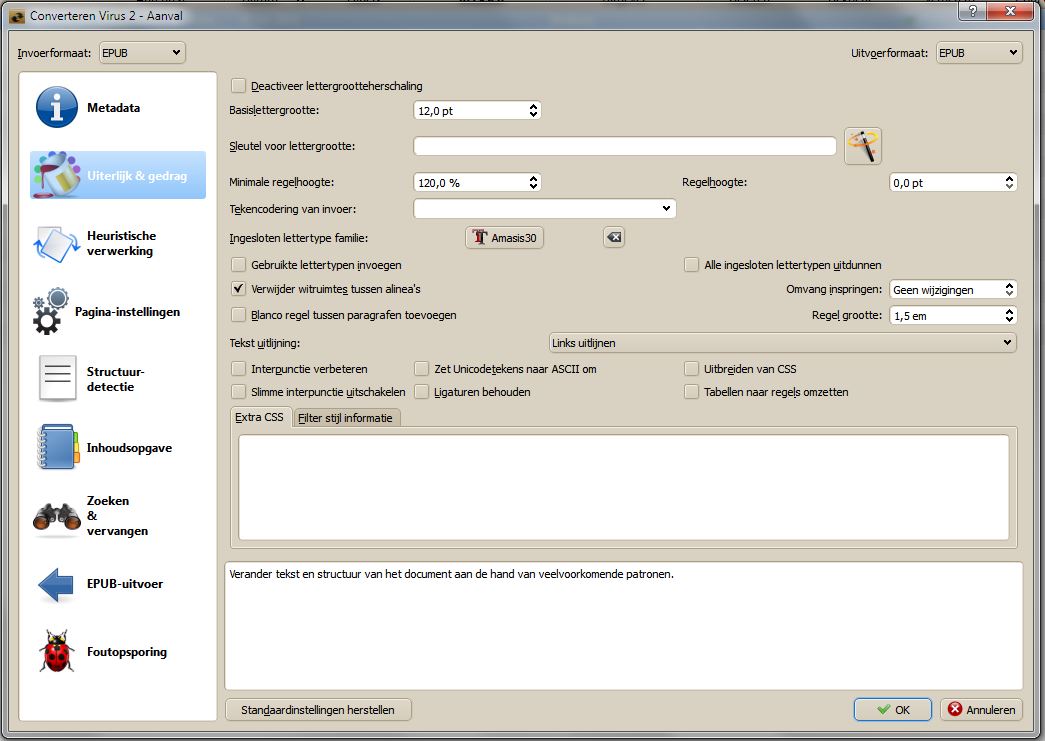

Now first my biggest problem.. to translate what I have on my calibre screen to english.
Minimum linehight is at 120% and linehight itself is 0.
Making the last one higher doesn't matter,because when the linehight 1.5 em is present in the .css of the book, it let it unchanged.
I can put the minimum linehight to, lets say 80% but then books that don't have a linehight specified in the css looks like they have been washed on to high temperature.
How can I get calibre so far to get all books with a linehight at 1.1 em.

I have included a screenshot of how my page look likes in my language.Click image for larger version

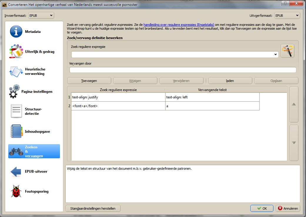

It works during conversion, you are quite right I didn't ask it to do in the editor.
In the editor it is more simple to just open css and remove the line.
But during conversion ( or mass conversion ) it works to, only with the terrible regex, I am not pleased but I gonna work with it.
Here is a screenshot ( in my language ) where to fill it in.
Name:	2014-04-05 10_49_19-calibre - __ Calibre Bibliotheek __.jpg
If you do a batch conversion, it also looks in the .css and replace it.

In Sigil this works, in Calibre not so it seems that search and replace for bulk conversion skips the css
I got to find something else and go back to my first screen,find the solution in the look and behave screen in this post : https://www.mobileread.com/forums/sho...78&postcount=1

Thats what I said, the search and replace looked like it was working on the .css but it was another setting that was changing something in the .css, So we have to go back to screen and post one. ( look and feel during conversion)
The problem I see there is the minimum lineheight 120 %.
That looks promising but books that have not specified the line-height in the .css or have another value will be affected to.
When I set it to low and do a batch conversion,all books that have no line-height or have a smaller value will be changed to.
You can't put a minimal lineheight in it, ( there is no option ) so it is useless in batch conversion.
The linehight button next to it, only changes the values when they are not set in the .css so if you put a line-hight there all sections in the .css that not have the line-heigt value in it will be updated with the new line-height, however, the section that has a pre-defined line-height ( and that is the section you want to change) will not be affected by this setting.
There should have been an option: set minimal line-height at 1.2 em ( or what ever you want ) lower will not be changed, heigher will be put back to the value specified.
Or at the other field (search and replace) an option for include .css
But how to ask this to the maker of Calibre, I tried in the past...
Most ideal would be an e-book that says, hey reader, tell me your settings and I act accordingly.
Now most of the conversion in e-pub to e-pub is a little bit useless,because after it, I still have to edit earch book to change value's in the .css ...
