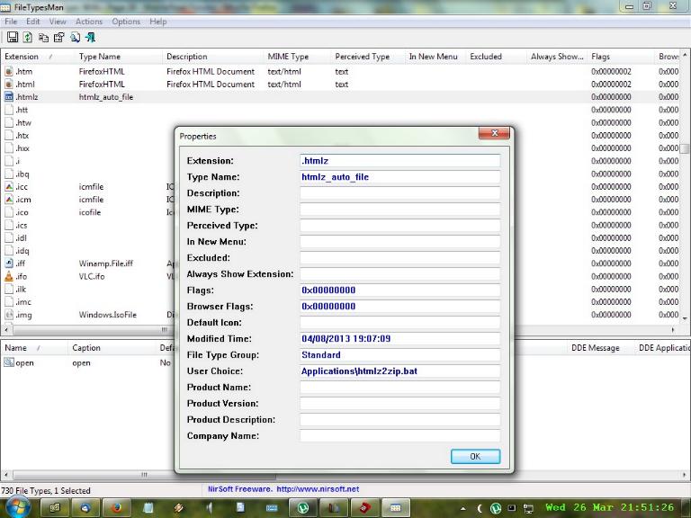

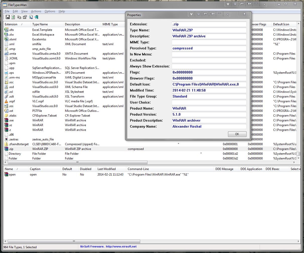

I need to see the details of the file association, IMO Windows tools are inadequate for this, so could you download this program http://www.nirsoft.net/utils/file_types_manager.html. The download links are towards the bottom of the page. Nir Sofer's programs are 'as safe as houses', you don't have to install them just unzip to a folder and run the executable.
The second attachment shows what I have associated for ZIP files (WinRAR), to get the Properties panel right click the HTLMZ line in the top panel and select Properties
Take a screen shot and post here via Manage Attachments. I mainly use the Windows Snipper Tool - search for snipper in start menu, suggest you pin it to taskbar (IMO the handiest), or start menu or create a shortcut on desktop.
ID:	120845   Click image for larger version

Screenshot from File Types Manager attached.

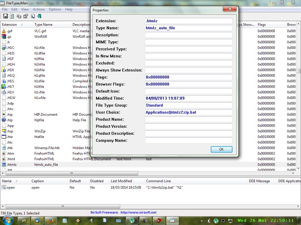

@Vortex - Darn - I need to see what's in the lower pane of File Types Manager - especially the Command Line column - I have an inkling that's where the problem will be.

File Types Manager attached again below:
