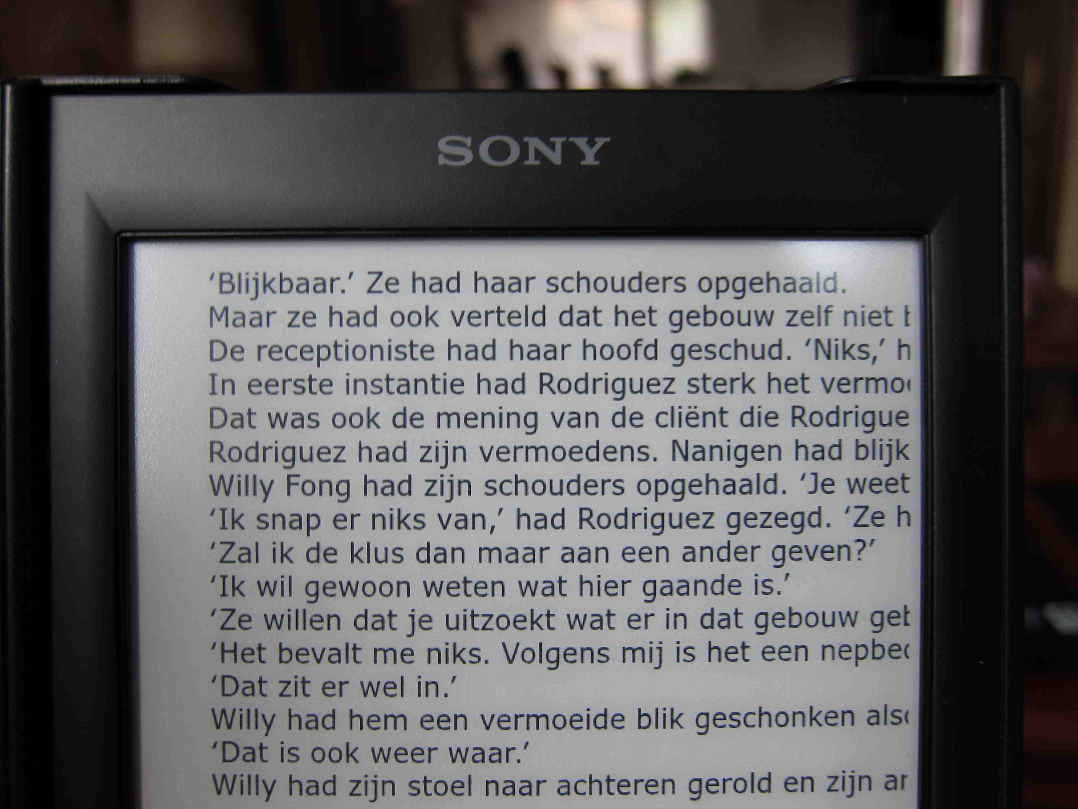

I have serious problems with word breaks on a Sony PRS-T2. I reported this on the Sony forums and all they could do is sending me to the support account. Sony support after months of e-mails and sending screenshots, book titles say that they cannot reproduce.
They say "It might be caused by the way you place the books on the e-reader". I am using Calibre. Great tool, I donated money to support the development. Could there be something wrong the way Calibre places books on the e-reader?
They asked me to send it to a support center or discuss with the vendor. I did the last and they were flabbergasted. Never seen or heard of this. They gave me a brand new PRS-T3 to test with. I placed my books on it and the same problems are there.
The books look OK when reading inside Calibre.
I enclose photos made from the Sony e-reader on a couple of pages with failures.
Anyone else seeing bad word breaks? Anyone that can comment on "Maybe there is something wrong the way you place the books on the e-reader"?

Looking at those screenshots, I dont see what is to be flabbergasted about? It looks like normal hyphenation for long words at the end of a line. Of course since I cannot read DUtch?, I dont know if the hyphenation is correct or not. Probably the files you are viewing have soft hyphens embedded causing the hyphenation.
In any case if you want to determine if calibre is causing hyphenation, simply copy one of those books to the reader without using calibre and see what happens.
When copying books to the reader all calibre does is update their metadata. The only way that can cause hyphenation is if it sets the language metadata and the reader then reads that and turns on hyphenation. Which you can prevent by clearing the language field in calibre.

Yes, the hypenation is incorrect. Hyphenation in Dutch should be done only on syllable breaks, and these examples break words in the middle of syllables.
I think the problem is that the hyphenation routine used in the Sony or in any other Adobe-based reader is lousy. I've seen this in other readers as well. It's not about Calibre, it's not about soft hyphens in the book, it's all about the software on the reader. In the end it's probably up to Adobe to do something about this.
I've seen this behavior in many books on several different readers. If the vendor says they cannot reproduce this they are not really trying.
Some readers have an option to turn off hyphenation. That's the only solution I can think of.

@Kovid: Thanks for replying and confirming that it is not Calibre that is doing something wrong as Sony suggests.
About flabbergasted I enclose another screenshot from the PRS-T2. The problem is also discussed at the Sony forums (http://community.sony.nl/t5/eReading...T2/td-p/359582). This problem is repaired by a firmware update after half a year of complaining and the Dutch consumers authority (Consumentenbond) contacting Sony. At that time I did not have Calibre yet (great software, thanks).
@Alex: Thanks for letting me know I didn't miss an option.
@Zetmolm: I did inform Sony - with screenshots - that the same pages look good in Calibre and bad in Digital Editions but Sony claims that they cannot reproduce.

you can turn hyphenation off by adding a line to the book's CSS - see threads on sony forum. You can use modify epub + extra css in calibre prefs, or do an epub to epub convert to get that code into each book
OP: The T3 uses a newer version of ADE renderer which hyphenates (badly and annoyingly) in English, the T2 & earlier models' renderer does not hyphenate at all in English.
the muppets who work for what Sony laughingly call "customer support" are clueless about their own products, as you've discovered.

because the words "responsibility" & Sony don't work in the same sentence
abobe - to be fair - have made hyphenation controllable, though they don't bother to document it, so you need forums like this to learn the commands from.
it' s Sony who have not bothered with a user preference, so you have to do it before side-loading the book - and if the book is DRM'd then you can't do it al all.
and as Sony are quitting the e-read market they won't ever fix it for you- .
So use the given workaround. you need to add this to your CSS:
body {adobe-hyphenate: none;}
cybmole is offline   Reply With Quote
