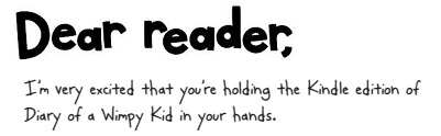

I wanted to read a Diary of a Wimpy Kid, but my Onyx M92 fails to open this file. I have upgraded firmware, but problem persists. I was wondering if it could be caused by a weird font used for this PDF file (see attachement). According to Foxit Reader there are 2 fonts used:
  • WimpyKidDialogue (Embeded Subset), True Type (CID), Encoding: Identity-H
  • WimpyKid (Embeded Subset), True Type (CID), Encoding: Identity-H
I also tried some online PDF validators, but there were no problems found for this PDF.
Thanks for your help.

It does not open the pdf file OR it opens the file, but the screen is blank?
Identity-H encoding is maybe the thing that causes a problém. Try to convert pdf so that it does not use Identity-H encoding.
You would have to probably print it to a virtual pdf printer (like e.g. Bullzip pdf printer), or change those two fonts to some other with e.g. Unicode encoding.

Thanks for tips. I printed the PDF file using Foxit Reader, but it didn't help. M92 seems to be opening the file, wheel is spinning for a while, but than it returns back to the File browser.
I don't know how to change the encoding, but printing the PDF to a virtual printer turns all text to bitmaps, so it shouldn't matter.

In that case, I do not know, what is the problém.
Try print PDF as bitmap if Foxit allows that and if you can choose it somewhere in setup, then not more than say 150 dpi. (Foxit might print pdf as vectors by default. It should be OK for M92, but it might cause problems....)
I do not have any problems with scanned texts. Even big books.

It seems, problem is solved. It looks like the only problem was, that filename contained # (Diary of a Wimpy Kid #1.pdf). After renaming the PDF file, everything works smoothly.
By the way, is this a known issue (filename shouldn't contain #)?
