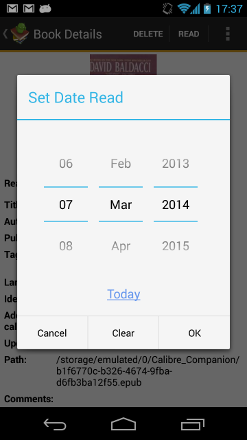

2) there doesn't seem to be a way to manually clear the date read field. That might be useful for some people.
Changed in next release. The attachment shows what the date picker looks like now. The "link" to set the date to today is there because Android really wants to limit the number of buttons in a dialog box to three. Clicking the link changes the date picker to today. You can change it further or hit OK.

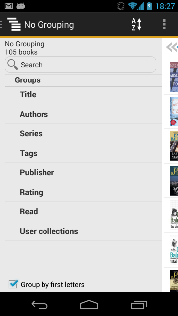

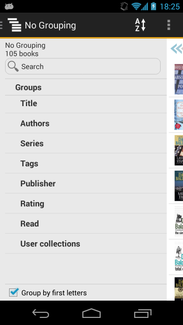

Not happy about using different font sizes, but I have no problem with spacing things out more.
The first attachment shows it as in 3.3.0d. The second shows it spaced out more. There is more space between the search box and "Group" (which is not clickable), and the space taken by "Group" is larger.
ID:	119967Click image for larger version
