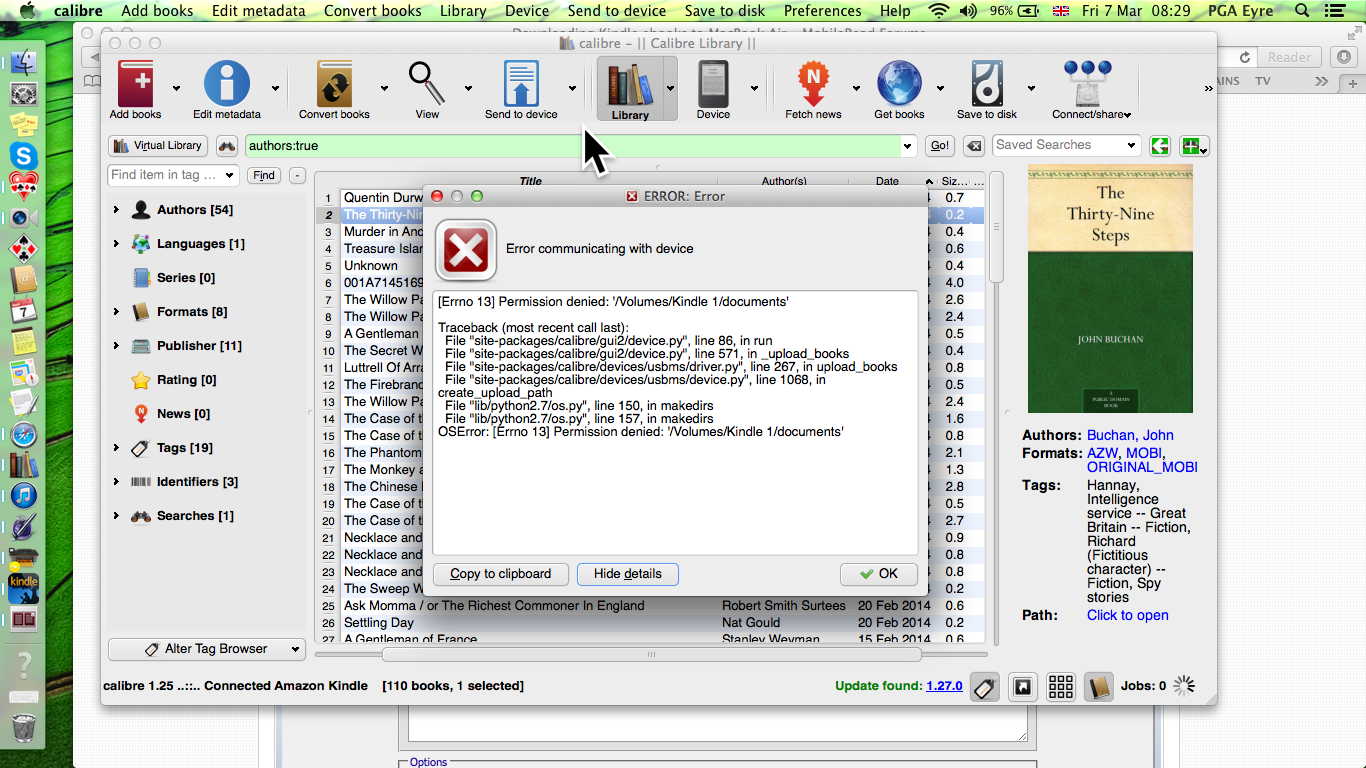

I installed Kindle for Mac, and downloaded 3 books from Amazon. Each is shown as being formatted in AZW.
I imported all 3 into my Calibre library.
I successfully converted 1 to MOBI, and uploaded it to the Kindle.
However, in the case of the other 2, I convert them, but they cannot be uploaded to the Kindle.
I get an error-message, a screen-capture of which I attach.
I shall persevere, and report back.
Thank you all.

But that doesn't explain that weird permissions error dialog, which I don't understand at all.
