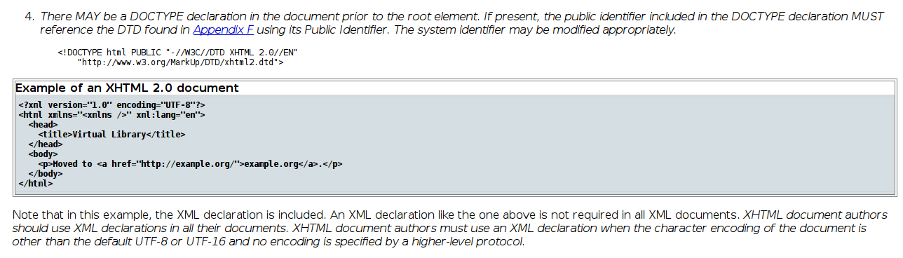

I speak about the common EPUB2 not about EPUB3, html 5 or anything else. I found in the xhtml 1.1 specs telling that the DOCTYPE was required (screenshot 2). But there is another one about xhtml 2 which says that it MAY only be required (screenshot 3) and is only necessary "when the character encoding of the document is other than the default UTF-8 and UTF-16" but it's a draft.
Which one applies to EPUB 2? How old is the xhtml 2 specification?
IDPF specifies for the EPUB 2.01 (May 2010), that the required MIME media type for application/xhtml + xml must be XHTML 1.1. That would mean that a DOCTYPE is required.

As far as I could understand, the DOCTYPE is indeed not needed.

But isn't the ePub 2.01 standard based on the second edition of the older xhtml 1.1. standard, which does require a doctype?

It is a bit technical, but for the XHTML spec the DOCTYPE is required. However, an ePUB must contain XML files, not per se XHTML. However, pure XML files will not work as far as I know...

It says it must be XML, with all elements (not in islands) from XHTML.
And then of course there's the specifications and there's the implementations
Old 02-23-2014, 04:14 PM   #6

Unicode characters work in every single place that entities work. Both unicode characters and entities require a declaration in the header. The DOCTYPE in the case of named entities and the character encoding in the case of unicode characters.
The DOCTYPE is an absolute requirement in order to use named entities in XHTML, while the character encoding is not, since the default encoding for XHTML is UTF-8 when undeclared, which is the encoding the calibre editor uses.
Therefore, named entities are actually *less* likely to work than unicode characters.
From what I can see, the second paragraph of this statement is ambiguous because it's both right and wrong.
- wrong, because formally, EPUB 2.0.1 which is the latest iteration of the official norm before EPUB 3, still relies on xhtml 1.1 specs, for which the DOCTYPE is an absolute requirement. Point.
- right, because technically, this DOCTYPE is only useful for named entities. So even if the DOCTYPE is required formally, it is not needed technically if all the code is made out of (UTF-16) Unicode characters.
I agree with Arios: there seems to be absolutely no compatibility problems arising from this suppression of the DOCTYPE as long as the EPUB 2 contains only (UTF-16) Unicode characters.
I don't see that. Where is it stated that ePub documents must be valid XHTML 1.1? As I said above, they must be vaild XML, with XHTML.
