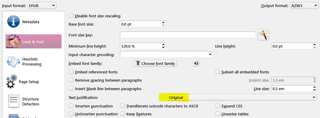

If you view the EPUB in the Calibre viewer and the text is justified, then the resulting AZW3 will be as well—provided that the option for text justification is set to "Original" or "Justify text" in the Look & Feel conversion options. See attached image.
If the EPUB text is left aligned, then set the option to "Justify text". You can also open the EPUB in the editor (Edit Book) and manually change/add the text-align property for the appropriate classes in the CSS—as Katsunami pointed out. The former method is obviously the simpler of the two.

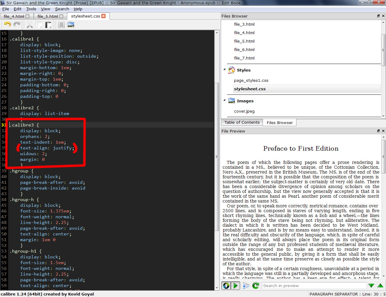

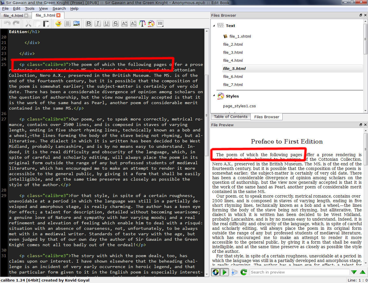

CSS is easy; it basically states how the text has to look. To justify a book that is not justified, you do the following:
- Open the EPUB using Calibre's "Edit Book".
- Click one of the chapter files.
- Find the CSS class that represents the main body text.
(See attachment 1.)
- In this book, the class is called "calibre3", but it can have any name.
- Open the book's stylesheet (in this case, stylesheet.css).
- Find the correct class: it can be either "p.calibre3", or ".calibre3".
(See attachment 2.)
- Change "text-align: left;" to "text-align: justify;". If there is no text-align property, then add "text-align: justify;" to the class.
- Save the book.
Done.
