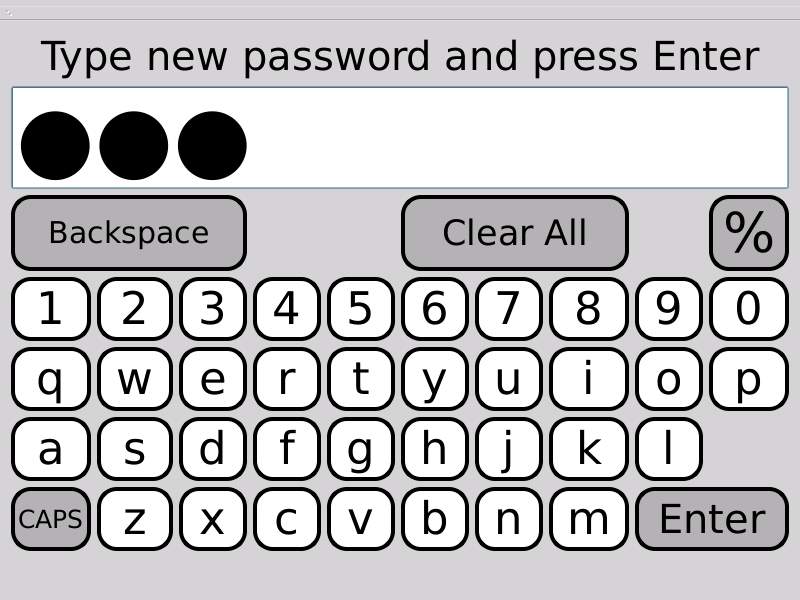

I wrote a little password checker for kobo readers. The main idea is to intercept the start up script at a certain point and ask for the password. If the correct password is entered the start up script continues, if a wrong password is entered (you get three chances), the device is powered off.
The security level is rather low.
  • I don't encrypt the password. If anybody has access to your running reader, he can find your password.
  • Anybody can factory reset your reader. (S)he will be able to use your reader as (s)he likes, any personal information however will be deleted.
  • If the device has a removable sd card, anybody with the necessary knowledge can open the device and grap any information from the sd.
As you see the protection level is not very high, but might suffice for some situations. As for the first security loophole, you might consider activating "Automatically power off after" in the Sleep & power settings.The second security loophole (factory reset) might actually be welcomed in case you forget the password.

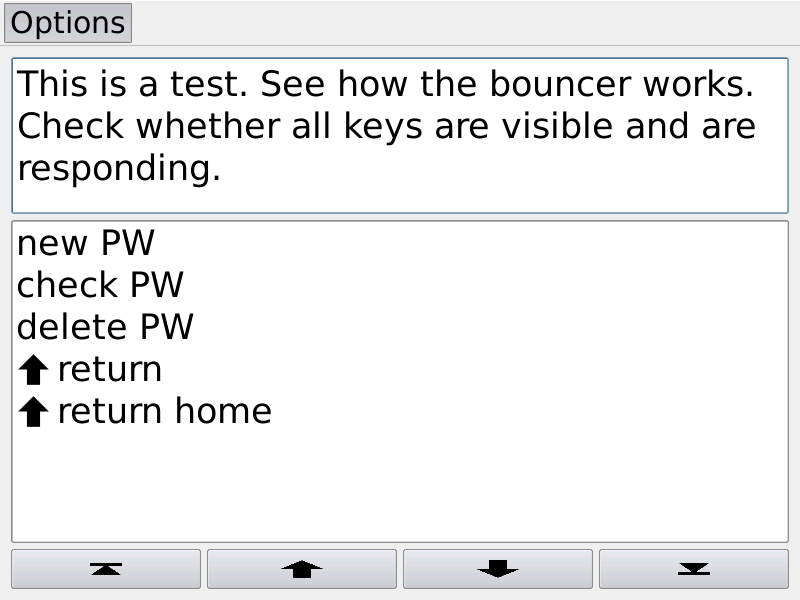

from the main menu go to "tools>activate>bouncer>test the bouncer.msh" (in some older versions of KSM: "scripts>activate>bouncer>test the bouncer.msh"); you should see something like the first image of this post.
  • select "new PW"; now you should see something like the first image of the first post (black letters on white keys)
    • type the new password and press enter; you will be ask to repeat the password
      • if you succeeded in typing the same password, you will see the message "new password: YOUR PASSWORD"
      • if you didn't, you will see "FIRST PASSWORD and SECOND PASSWORD do not match"

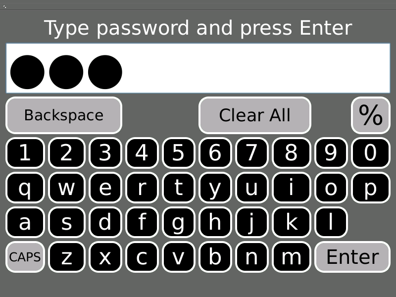

  • select "check PW"; now you should see something like the second image of the first post (white letters on black keys)
    • type the password and press enter
      • if the password matches, you will see the message "ok"
      • if the password does not match, you will get two other chances; if it still doesn't match, you will see the message "failed"
      • if there wasn't set any password to start with, the password checker will not be launched, and you will see the message "pass without checking"
  • select "delete PW"
    • if you now select "check PW", you should get informed that you can "pass without checking"
Play around with this for some time and see whether it works for you. Only then proceed to the next step.

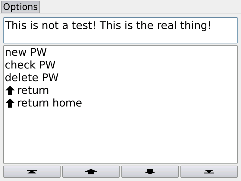

from the main menu go to "tools>activate>bouncer>settings.msh (in some older versions of KSM: "scripts>activate>bouncer>settings.msh"); you should see something like the second image of this post. Set a new password and check it as you did while testing. If you set a new password (and you don't delete it), the password protection is activated. After the next reboot, you cannot continue without typing the correct password. You can anytime call settings.msh in order to change or delete the password.
If you forget your password, you will have to factory reset your reader.
Note: the "%" key toggles between masked and un-masked display of the input text.
