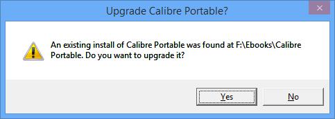

I've done a search but I cannot find a solution...
Is there a command line option/parameter to avoid the "Update existing portable installation" (or words to that effect) dialogue when updating an existing Calibre Portable installation?
I'm trying to set up a silient update process and that is the only thing stopping it at the moment. I have the installation directory sorted as per the Calibre Portable download page.
Thanks in advance.

Hi Kovid, I've read that bit and that is how I know how to specify the directory that Calibre Portable will install to (as stated in my initial post). What I want to avoid is the Yes/No dialogue that pops up asking if I want to update an existing portable installation.
Edit: I have added a picture of the dialogue box in question.
Name:	Upgrade Dialogue.jpg

There's no way to avoid that using just the installer. If you want to avoid it, create a batch file that first deletes the existing install folder and then runs the update.
Of course, to be robust you would need to move the existing folder elsewhere instead of deleting it and then move it back on failure or delete it on success.

I spent the majority of yesterday playing with AutoIt scripts, having it download the latest installer file, check to see if an install already exists and if it does, update it (moving the 'Calibre' folder to a back-up location first). During the update process, my script automatically closes the 2 pop-up dialogue windows - the 'Confirm update' as previously detailed above and the 'Success' dialogue. It's a bit messy but it works for me.
I now need to adapt my script for your changes. Now if you could just lose that 'Success' dialogue box as well, I wouldn't need my script at all .
For those wondering how Kovid's new option kicks in, you must specify an install path when running the portable install file e.g.
calibre-portable-installer.exe "C:\Calibre Portable"
