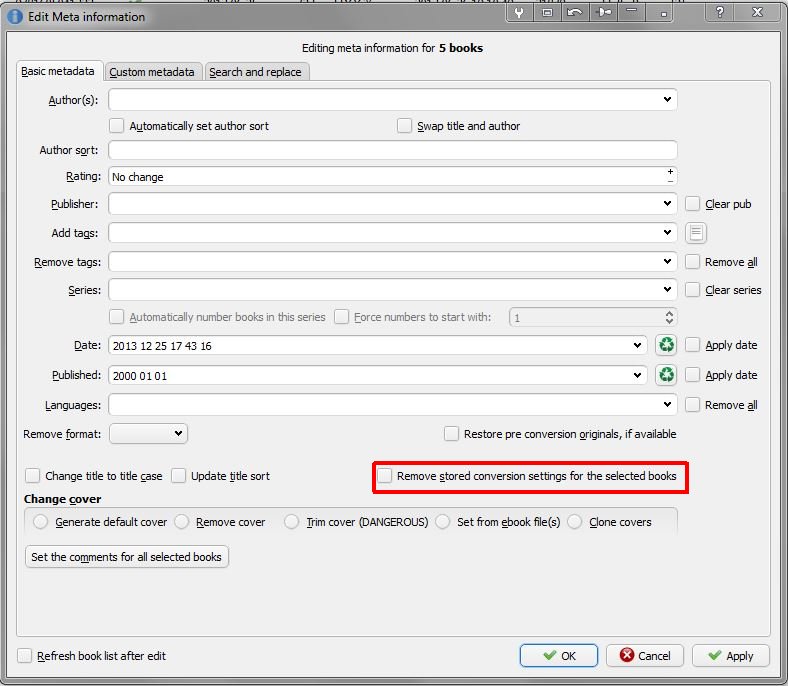

Converted everything from epub to azw3 and trying to do a bulk conversion of azw3 to azw3 to remove any lingering issues, but I can't for the life of me figure out how to keep it from selecting epub as the input format. Any guidance would be appreciated.

I don't think that can be done (at least Easily). Calibre remembers the last conversion setting used for EACH title (unless you use the Tick to reset to defaut)

You can bulk remove stored settings see attachment
