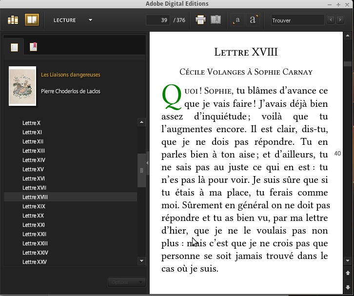

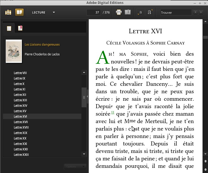

Hi
This is what I am using for plain text. I am aware it's a bit complicated ( I have one font for dropcap display and one for small caps) but it works well with ADE and i have been using it for a long time now. I need to differentiate because of the size and shape of some letters.
Using a double span (let1 and let2 or 4) to code the dropcap helps to place it precisely. Hopefully, this latter part of the code could be adapted for poetry.
I insert for example this in the CSS
/*Réglages Lettrines DEUX LIGNES ADE a été privilégié p/r à Sigil.*/
.let1{
display : block;
float : left;
margin-top : -0.5em;
margin-left : 0.0em;
margin-right : 0.2em;
height : 2.2em;
.let2{
font-family:'Linux Libertine Display-Regular';
font-size : 3.3em;
line-height : 1.1em;
color:green;
/*Réglage Lettrine J, Q et Ç (let 2 vers let4) */
.let4{
font-size : 2.9em;
color:green;
then this, still in the css
span.smcpTypeA {font-family:'Linux Libertine O C';font-size:95%;font-style:normal;margin-left:-0.4em;}
span.smcpTypeV {font-family:'Linux Libertine O C';font-size:95%;font-style:normal;}
p.let {margin-left:0.8em;margin-right:0.8em;margin-top:0.3cm;margin-bottom:0.0cm;border:none;padding:0;background-color:transparent;text-indent:0.0cm;text-align:justify;}
In code view it may look like this:
<p class="let"><span class="let1"><span class="let2">N</span></span><span class="smcpTypeV">ous croyons</span> devoir prévenir le public, que, malgré le titre de cet ouvrage et ce qu’en dit le rédacteur dans sa préface, nous ne garantissons pas l’authenticité de ce recueil, et que nous avons même de fortes raisons de penser que ce n’est qu’un roman.</p>
It looks like these in ADE (see screenshots)
I also use a regex to put them in place:
S: <p class="let">([A-ZÉÀÔ])
R: <p class="let"><span class="let1"><span class="let2">\1</span></span>

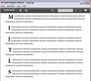

I'm not quite sure, if I have understood the problem, but without any indent and margin-left instead to the dropcap it seems to be OK with ADE, Calibre, Sigil and Firefox.
The sizes are:
.dropcap {
float: left;
font-size: 2.42em;
font-weight: bold;
line-height: 1.2em;
margin-bottom: -0.2em;
margin-top: -0.1em;
margin-left: 0.5em;
margin-right: 0.15em
George
