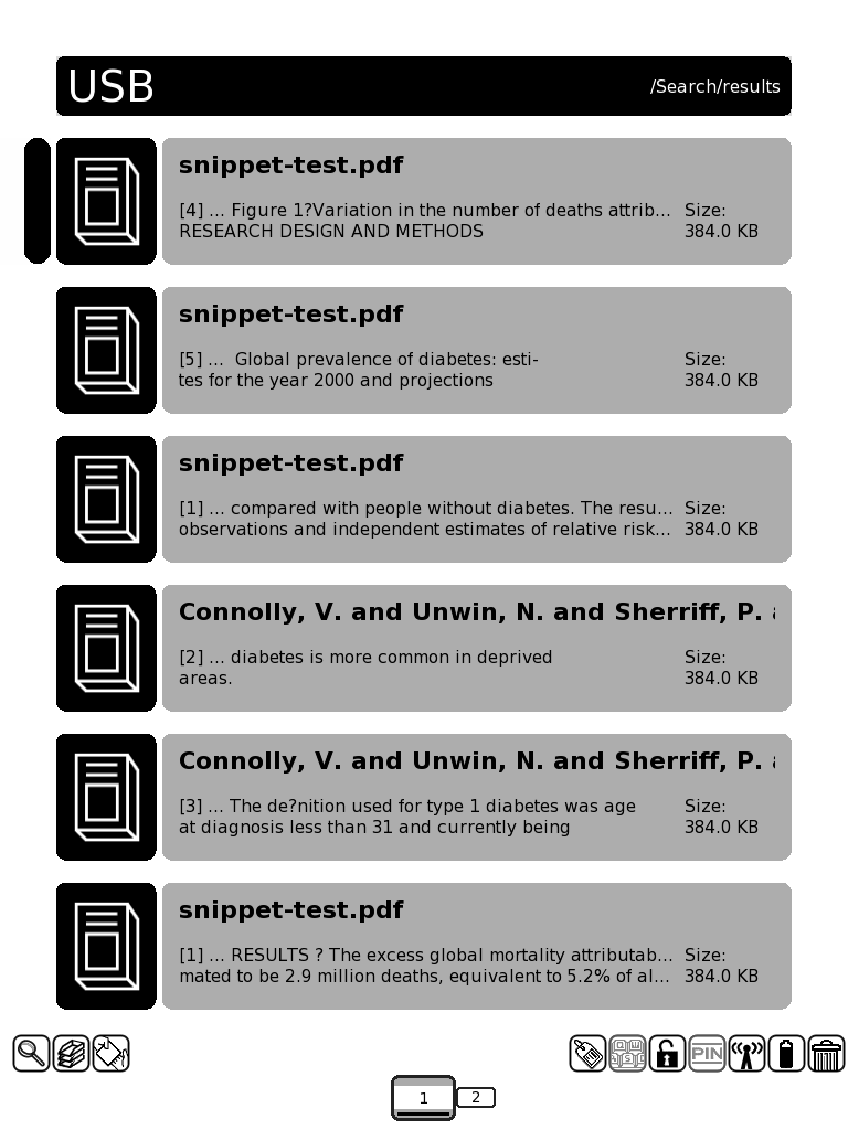

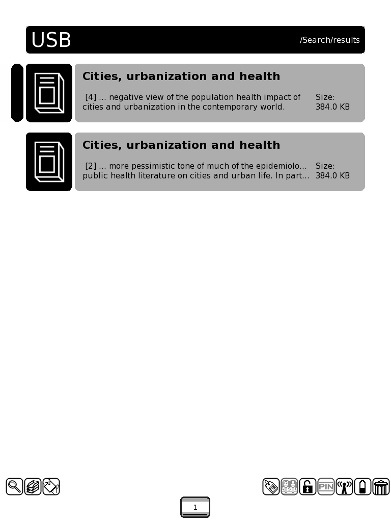

Here's something else to think about with this. It is possible to extend the multi-directory search script to search the snippets and create result entries that are more than just symlinks to the matching PDF. The result could contain the title from the original PDF and the description can contain the context from the snippet that matches, including the page number of the match. It is possible to have multiple matches per PDF. Moreover the manifest can be crafted to open the PDF at the page number of match. I have tested each step necessary to do this, but have not got the whole lot together. All of this uses shell scripts and the stock awk and sed that comes with the iliad so there is no software to install, just the search script.
The snippet extraction plus search tool means the following work flow is possible:
  • search for and download refs as PDFs (probably on a PC)
  • copy refs to the iliad (CF, USB, internal memory, wherever)
  • go find a nice comfy leather chair or bean bag, or sit in the park [important step]

Here's a screenshot of a match for the word "urban" in my test case. Both results are from the same original PDF, but relate to snippets from different pages. The page number of the match is in square brackets.
I am also starting to think about extending the logic of the searches and having a "combine" entry. It should be possible to make several searches and keep each set of results and then combine them (like the ovid command line syntax). This would mean you could:

snippet search now works
I've added a snippet search tool to the multi-directory search tool. This allows you to search within snippets and produces results that show the title of the original file plus a couple of lines of the context of the match (in the description). The description starts with the page number in the original PDF where the matching snippet comes from. I was not able to make this open on the matching page (at least not nicely), but this allows you to see which page to jump to once you open the PDF (via the result set).
This tool uses the same config tool to decide where to search so you could set up directories of PDFs and then choose to only search within some. Here's an example of the result of a search.
