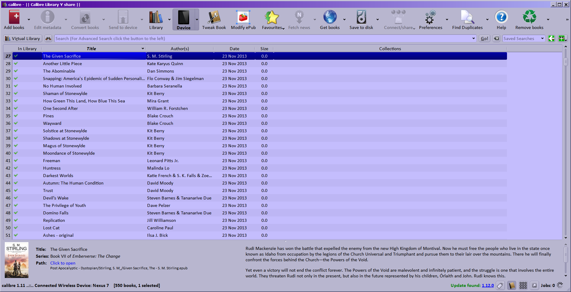

Thanks, but I only want to remove one of the duplicate books from my tablet, but not both. If sorting by title in the device worked, I could find a specific book and then delete only one. Here's a screen print of the books on the device after clicking on Title - it's not in alphabetical order.

I was showing device view because that's where I can't sort by title so I couldn't find the books. I still don't understand why the device view doesn't sort though.
Uhhh ... It doesn't sort because it is broken.
Without going into detail, the changes in calibre to speed up CC's connections had the side effect of breaking sorting by title in calibre's device view. I have submitted changes to Kovid to fix it.

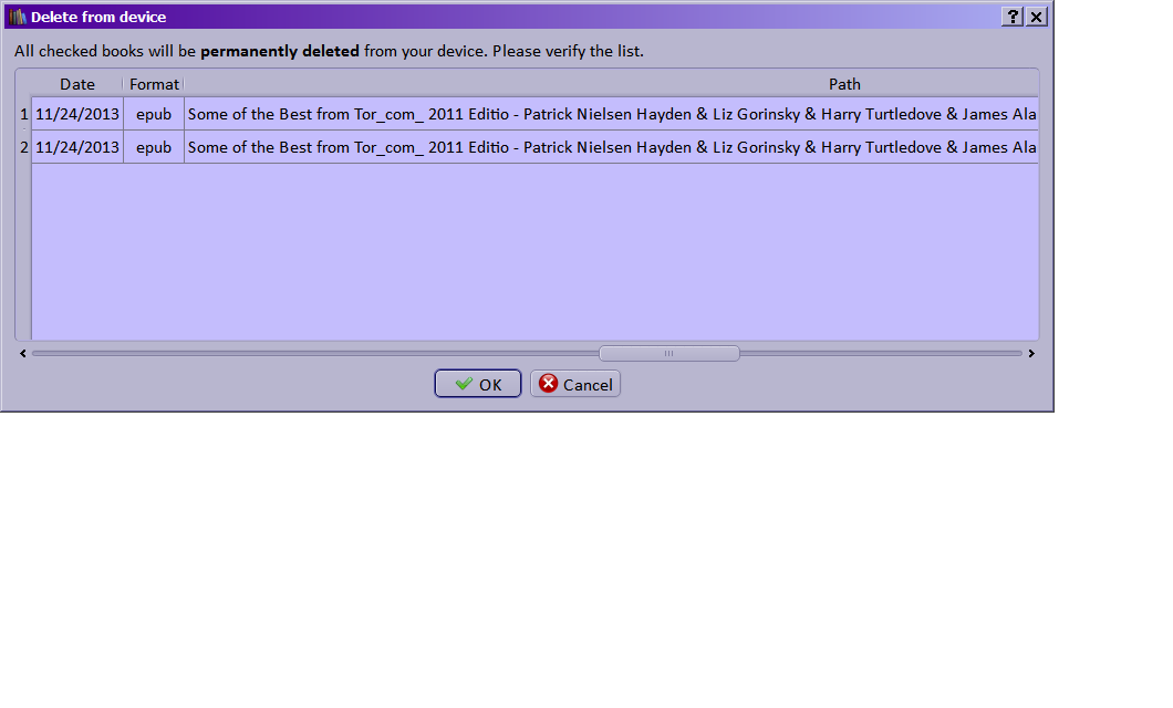

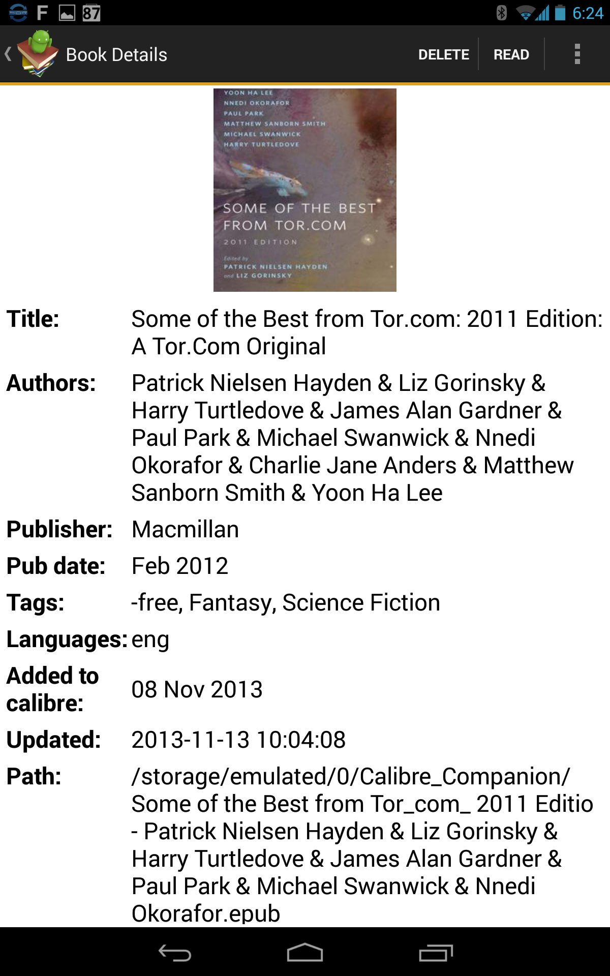

I have an additional issue - the path shown is not correct. here's a screen print from Calibre after selecting remove matching books from device, and two from CC showing the details for the two books with the path for each. The path in Calibre shows as the same for both, but they are different in CC.
I can see what happened. Somehow you got two identical copies of a book (same unique identifier, same format, different paths) onto the device. Calibre and CC conspire to ensure that this does not happen. Apparently they failed in your case for reasons mysterious. Still looking.
The way to fix it is:
1) connect CC to calibre
2) delete either copy of the book in question
3) disconnect CC
4) reconnect CC
5) delete the remaining copy (it should now have the other path)
6) resend the book.
Deleting both copies during the same connect won't work because of the path name problems.
