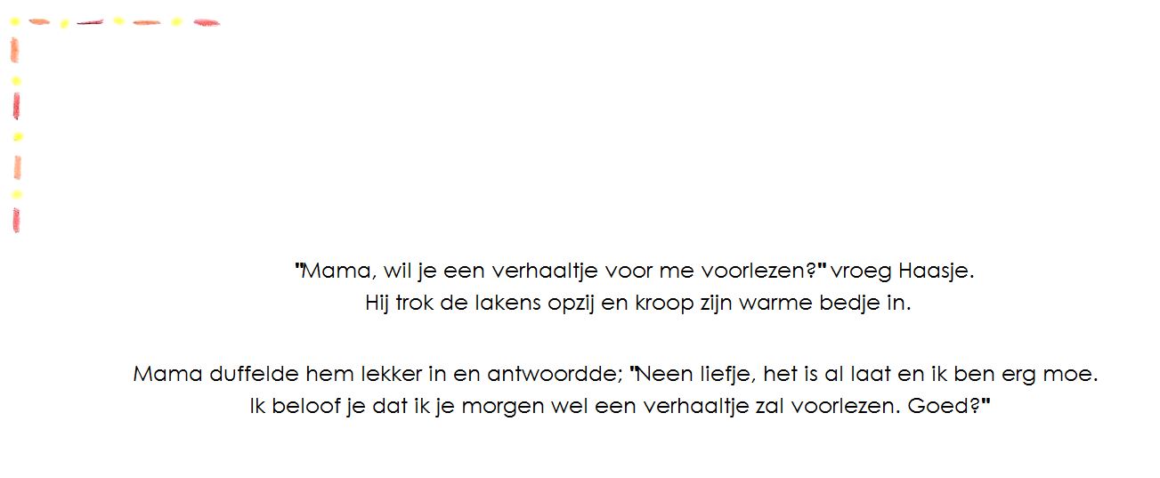

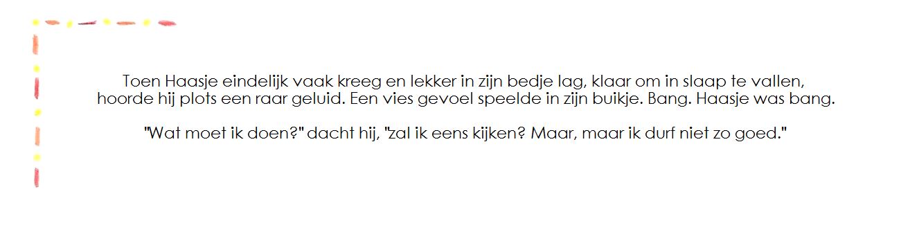

Hello,
I'm new to Sigil and I'm trying to create an e-pub for the book that my daughter made. It contains a lot of images and I'm having trouble to get the text near and in front of the image. In the attachment you will see a left top corner image and the text beneath it although the text should be like attachment 2. I more or less can get it done in Sigil playing aroung with the positioning (margin-top/margin left) but when I look at the result in my e-pub viewer (adobe digital editions), the image is not what it looked like in Sigil.
Can anyone point me in the right direction?
thanks in advance
Stephaan

Those kind of effects will be hard to do in normal ePUB. They would be possible with fixed-format ePUB, but then you are limited to certain readers/reading applications.
In this particular case you could try to make it two images. One horizontal and one vertical. The vertical can be floated left. You could try.

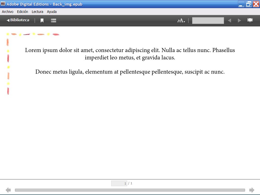

Do the following:
1. In your stylesheet.css file, write:
.back_img {
    background: url("../Images/Background.png") 0 0 no-repeat;
    background-size: contain;
    height: 200px;
    text-align: center;
    font-size: 1.2em;
    padding: 1.5em 2em;
2. In your .html file write:
<div class="back_img">
    <p>Lorem ipsum dolor sit amet, consectetur adipiscing elit. Nulla ac tellus nunc. Phasellus imperdiet leo metus, et gravida lacus.</p>
    <p>Donec metus ligula, elementum at pellentesque pellentesque, suscipit ac nunc.</p>
</div>
After that you'll get something like the screenshot below. This method also works in ADE I attach the respective .ePub
Regards
Rubén
PS: In my example I'm using as background a .png image of 222 x 259px. Of course, you'll use your proper image with the size of your convenience since the property "background-size: contain;" will do almost all the work

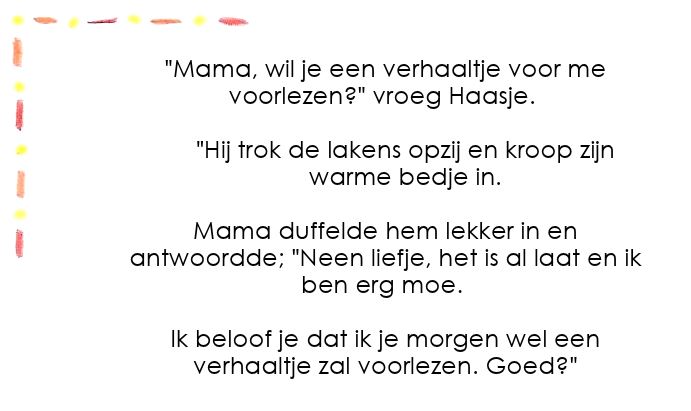

Thumbs up nice solution
Dear Rubén
thank you very much for your solution, especially on behalf of my daughter. Your reply was just what I was looking for. I attach the result .
I can use this feature for other images (as there are quite some) and for her second book she recently published (also with a lot of images)
Thanks again.
Stephaan (and Hannah)
