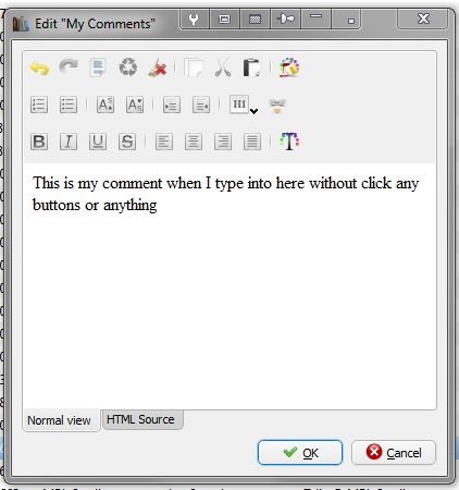

Edit Custom Comments Font
The font for custom Comments columns always defaults to Times Roman, could it be made to use the default value like standard Comments text.
Old 10-16-2013, 01:10 AM   #2
Posts: 46,637
Karma: 29634066
The font where? In Book details?
Old 10-16-2013, 02:11 AM   #3
Posts: 22,960
Karma: 34252880
In the edit panel itself - see attachment
In doing that screen capture I discovered that if click into HTML View and then click into Normal View it comes back as the default font - if I include My Comments column in Book Details it displays in the default (MS Dlg 2) font
I normally paste the following into HTML Source panel of the My Comments column before I start to type
<div><font class="Apple-style-span" color="#ffffff">.</font><div><b>My Comments</b></div><div><br></div><div><b><br></b></div></div>
Don't ask why the snippet is as it is, I lifted it from somewhere and it does the job, that's all I care about. I have a similar snippet that I put at the top of Standard Comments
I was trying to figure out a way of not having to paste the snippets
Old 10-16-2013, 02:43 AM   #4
Posts: 46,637
Karma: 29634066
You're saying this happens only for the custom comments edit box and not the builtin one?
Old 10-16-2013, 04:31 AM   #5
Posts: 22,960
Karma: 34252880
Correct - only custom Comments in the standalone editor - not custom or standard comments in the Metadata editor.
You may recall the frustrations I expressed with Metadata Edit and its layout of Custom Comment columns at launchpad.
That was solved when I discovered I could have custom comments shown in the spreadsheet, that I could edit them by pressing F2, and I could make them look half decent by hiding them behind column icons with no text. Incidentally I regard this feature of calibre as manna from heaven - I now only use the bulk Metadata Editor.
Had I known that in trying to get rid of the pesky html snippet pastes that I would, as a consequence (not as a cause), lose my column icons I wouldn't have bothered
