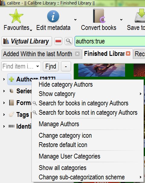

If you go to the tag browser and right click on the Author item then choose Manage Authors does the author and sort look correct in this list (see attached)?
