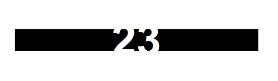

The attached file is a graphics mock-up of what I want to accomplish. I want the characters to "bleed" off the edges of the rectangular background.
In the CSS, I have set the background color to black, and the font to white, and played around with floats, padding (negative padding), etc, but without success.
Is this even possible with CSS? Or must I work out a solution using a graphic image for the background?
Does anyone have suggestions?

You should be able to do this via SVG, for CSS I have to think. It sounds doable... Perhaps via a table?

This seems to work:
font-family: sans-serif;
text-align: center;
color: white;
width: 30%;
margin-left: 35%;
background: black center;
font-size:2em;
line-height: 0.7em;
height: 0.5em;
It seems to be the last three lines, that does the magic. It looks crappy in Sigil (cuts of the bottom of the characters), but ok in ADE:

Old 09-13-2013, 07:00 PM   #4
Posts: 32,055
Karma: 65709392
To what e-librarian did
just add
padding: 5pt ; <sweeten to taste this insures background all around

Whatever you do, it will only work with black text on white background (or any color on white background, at most). Switch to "night mode" and you'll only see the big white numbers and no black box.
I did a quick search to see whether there is some way of inverting text and background colors with CSS3, but didn't find any.

Whee! I'm back after 3 days off-line, and got some nice answers.
@elibrarian, I am trying your code, and it works. and @theducks, thanks for the tweak (though in this case I don't want background on the top and bottom edges, I will use it another time for a different effect.)
Jellby, I hadn't thought about night mode. And maybe simple big white numbers would not be a bad fallback. But I am going to experiment with adding some white borders to a surrounding div (or borders to match the font color), so if the black bar disappears, the border could contain the numbers.
Thank you guys, for responding!

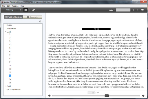

Well, after a bit of work, I could find something that ALSO works in ADE . In your .css stylesheet, write:
h2 {
  height: 60px;
  margin-bottom: 40px;
  background: black;
.text {
  float: left;
  width: 15%; /* this in linked with the left margin below */
  line-height: 100%;
  font-size: 94px;
  text-align: center;
  color: white;
  margin: -10px 0 -10px 42.5%;
And in your .html file write:
<h2><span class="text">23</span></h2>
The text is "floated-centered". I do that by asigning a width to the text block (in this case is 15% but feel free of changing it) and setting a left margin according to that width (in this case, since the width is 15% then the margin-left is [100%-15%]/2 = 42.5%). Also you can play with the font-size and the height of the header (h2).
That's all
Below you can see a screenshot of my ADE and I attach the respective ePub.

Reuben, I've played with your code, using ems instead of px, and it came out quite nicely in ADE. I'm not sure if the height and line height would work on other readers. (probably not, all my ideas lately seem to be too fragile to go hiking around outside of ADE!) It does not look well in Calibre Reader, so probably not good under QT.
h2 {
  height: 1em;
  margin-bottom: .5em;
  background: black;
.text {
  float:left;
  width: 50%;
  line-height: 112%;
  font-size: 2em;
  text-align: center;
  color: white;
  margin: -.25em 0 -.25em 25%;
Thank you so much!

Note, too, that different fonts have different relative size of characters in the "em-box", so that 1em may match the height of numbers in one font, but not in another. That will be especially noticeable with "old-style" digits, try Georgia for instance.
