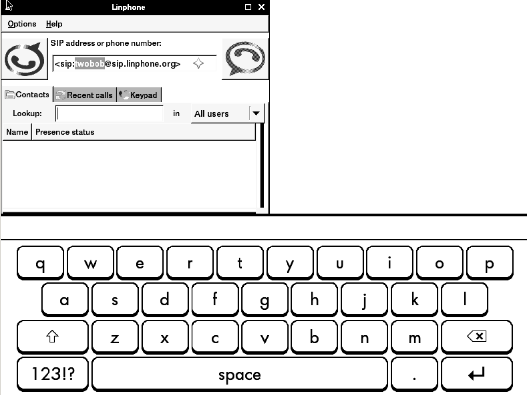

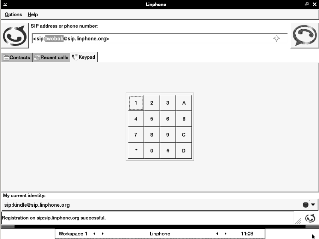

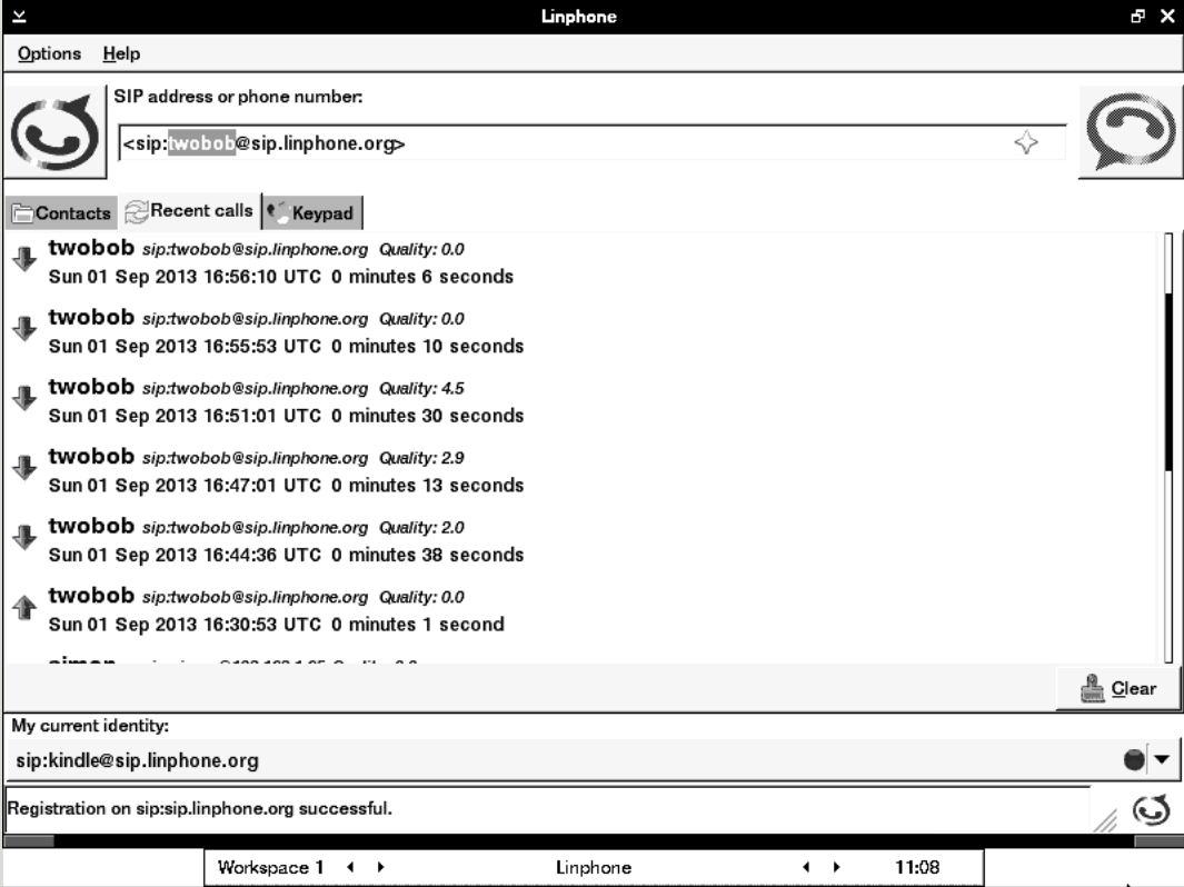

Post linphone, open-source voip software
http://www.linphone.org/eng/screenshots/desktop.html
http://www.linphone.org/eng/document...-linphone.html
http://www.linphone.org/eng/linphone...e-account.html
known issues:
Typing currently puts out unwanted characters. Deletable but fiddly.
Solution: an alternate keyboard may be more suitable or a solution with xmodmap perhaps.
preferences page too wide for 600x800 resolution screen.
Solution: runs landscape in Xephyr
Doesn't fullscreen by default
Solution: click fullscreen button, should fix with something better.
To be honest it is quicker to edit the /mnt/us/extensions/linphone/.linphonerc
file sometimes than fiddle with the menus. but once it's all setup nicely it works fine.
Someone should look to build this native IMHO.
ID:	110318   Click image for larger version
ID:	110319   Click image for larger version
