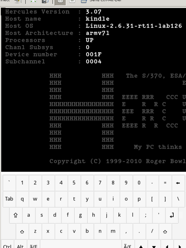

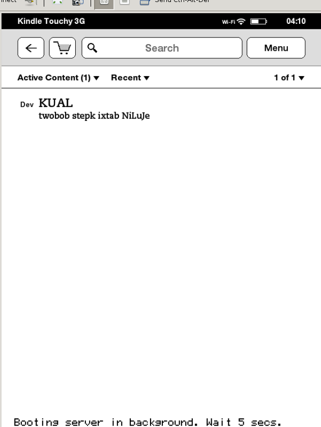

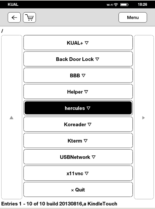

EDIT: (version 0.2)
Now includes a Client and several variations of boot.
The top button is the one most users would want.
Server (SILENT) + Client

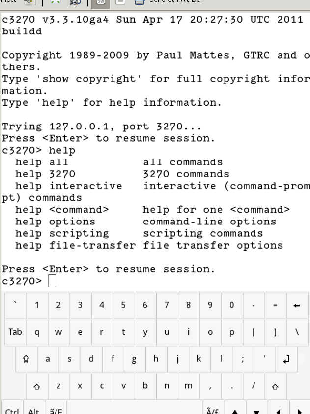

[root@kindle root]# LD_LIBRARY_PATH=/mnt/us/extensions/hercules/lib/hercules:$LD
_LIBRARY_PATH /mnt/us/extensions/hercules/bin/hercules
Hercules Version 3.07
(c)Copyright 1999-2010 by Roger Bowler, Jan Jaeger, and others
Built on Jun 18 2011 at 16:18:09
Build information:
Debian
Modes: S/370 ESA/390 z/Arch
Max CPU Engines: 8
Using setresuid() for setting privileges
Dynamic loading support
Using shared libraries
HTTP Server support
Regular Expressions support
Automatic Operator support
National Language Support
Machine dependent assists: (none)
Running on kindle Linux-2.6.31-rt11-lab126.#1 Tue Jul 17 16:55:47 PDT 2012 armv7l UP
HHCHD018I Loadable module directory is /usr/lib/hercules
Crypto module loaded (c) Copyright Bernard van der Helm, 2003-2010
Active: Message Security Assist
Message Security Assist Extension 1
Message Security Assist Extension 2
HHCCF003S Open error file hercules.cnf: No such file or directory
HHCIN900I Begin Hercules shutdown
HHCIN901I Releasing configuration
HHCIN902I Configuration release complete
HHCIN903I Calling termination routines
HHCHD900I Begin shutdown sequence
HHCHD901I Calling hdl_term
HHCHD950I Begin HDL termination sequence
HHCHD951I Calling module *Hercules cleanup routine
HHCHD952I Module *Hercules cleanup complete
HHCHD959I HDL Termination sequence complete
HHCHD902I hdl_term complete
HHCHD901I Calling logger_term
HHCLG014I logger thread terminating
HHCHD902I logger_term complete
HHCHD909I Shutdown sequence complete
HHCIN904I All termination routines complete
HHCIN909I Hercules shutdown complete
Getting there

Success
_LIBRARY_PATH /mnt/us/extensions/hercules/bin/hercules -f /mnt/us/extensions/hercules/hercules.cnf
Build information:
  Debian
  Max CPU Engines: 8
  HTTP Server support
HHCHT001I HTTP listener thread started: tid=40B8F470, pid=5539
HHCCF066E Invalid HTTPROOT: "/usr/share/hercules/": No such file or directory
HHCCF065I Hercules: tid=4001D1F0, pid=5539, pgid=5539, priority=0
HHCRD010E Unable to access file "./util/zzsacard.bin": No such file or directory
HHCCF044E Initialization failed for device 000C
HHCTE001I Console connection thread started: tid=40B8F470, pid=5539
HHCTE003I Waiting for console connection on port 3270
HHCTT002I Timer thread started: tid=44DC9470, pid=5539, priority=-20
HHCCP002I CPU0000 thread started: tid=44CC9470, pid=5539, priority=15
HHCCP003I CPU0000 architecture mode ESA/390
HHCPN001I Control panel thread started: tid=4001D1F0, pid=5539
  Automatic Operator support                                                   +
HHCAO001I Hercules Automatic Operator thread started;
          tid=45158470, pri=0, pid=5539
Command ==>

Yeah....
The config line:
HTTPROOT /mnt/us/extensions/hercules/share/hercules # HTTP root directory
refuses to be serviced... for whatever reason?
So... Ill package it. as-is. with a link to
http://www.ibiblio.org/jmaynard/turnkey-mvs-3.zip
as you kindly suggest.
And then move onto Win95
[root@kindle hercules]# cd /mnt/us/extensions/hercules/; LD_LIBRARY_PATH=/mnt/us/extensions/hercules/lib/hercules:$LD_LIBRARY_PATH /mnt/us/extensions/hercules/bin/hercules -f /mnt/us/extensions/hercules/hercules.cnf
Build information:
Debian
Max CPU Engines: 8
HTTP Server support
HHCHD018I Loadable module directory is /mnt/us/extensions/hercules/lib/hercules
HHCHT001I HTTP listener thread started: tid=40B8F470, pid=5557
HHCCF065I Hercules: tid=4001D1F0, pid=5557, pgid=5557, priority=0
HHCTE001I Console connection thread started: tid=40B8F470, pid=5557
HHCTT002I Timer thread started: tid=44DC9470, pid=5557, priority=-20
HHCCP002I CPU0000 thread started: tid=44CC9470, pid=5557, priority=15
HHCPN001I Control panel thread started: tid=4001D1F0, pid=5557
Regular Expressions support +
tid=45158470, pri=0, pid=5557
Command ==>
CPU0000 PSW=0000000000000000 24M....... instcount=0
But yeah. Works great. (I think)
When I package it up: Maybe add the OPTION to loopmount the "Invalid HTTPROOT:" to something sensible.? Or perhaps I'll just hardcode that.
the impact on the "Root" will be the creation of one innocuous folder.
Hardly devastating.
