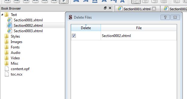

How does one delete?? That didn't seem to be in the User guide.
Deletes are easy (sometimes too easy)
Select the file or files and then [Del] key or right click
Paul

Old 08-18-2013, 10:05 PM   #4
Posts: 31,534
Karma: 62543878
With V7 you then need to confirm (or deselect) the deletes shown in the list .

hmmmm. delete isn't working for me. That's what I expected. To highlight it and then hit delete. but it does nada. Any ideas? I'm on 7.2 thanks

The issue is that you can't delete the last html file in the book...you must import your new files FIRST, then you can just select the file by clicking and hit the delete key.
