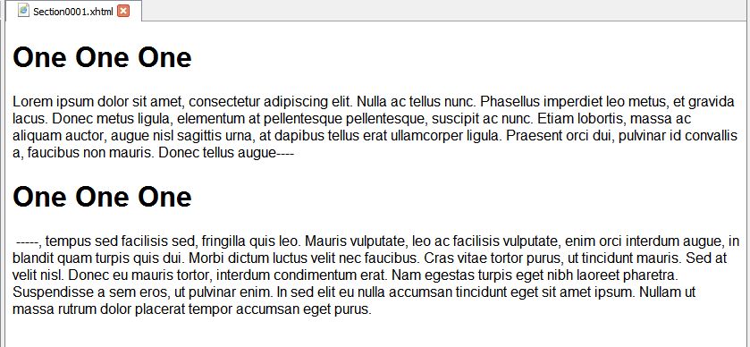

I cannot find the simple Paste, i.e. just the text w/o any formatting that works in BV
So if I wanted to copy the H1 para in BV and paste just the text into the next para HERE, the tags also get pasted. I was wondering if there were a 'format-less' paste.
CV works fine, but BV will often try to 'help' me by maintaining the formatting with a lot of {style = ....} and I end up with the screen shot

Originally Posted by phossler View Post
I remember your clips posting - very helpful
Paul
Technically, you can't have a format less paste.
In Sigil has to be a P or H or possibly a Div.
But it is easy to change in BV or CV
Paste that h# text
Now set the insert point (click) on the line: Ctrl-7 (same as clicking the P button

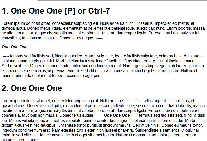

@theducks --
Agreed
In BV your recommendation seems to paste the h# tags, and then the [P] does change to <p> format. Issue is that it leaves the old H# text in a para by itself, (1) in the screen shot. (the Bold-Italic-Underline just a marker)
For this sort of stuff, CV will be my friend
Paul
@theducks --
Agreed
Paul
any class assigned does not change when switching
<h3 class="foo"
becomes
<p class="foo"
Now if your style sheet was:
h3.foo (
and you only had a:
p {
The foo would be ignored

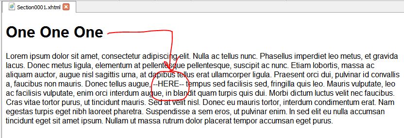

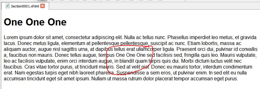

Sorry, I'm not being more clear, but I wasn't refering to class = ....
In the screen shot
1. Copy the "One One One"
2. Select the HERE in the text and Paste (ctrl-v)
(makes another h1 as a seperate para, and 'splits' the text para)
3. Ctrl-7 or [P] on the pasted "One One One" (makes it <p> level)
I was wondering if there was a way to just insert the clip board text at the HERE, without any tags or formatting, so that I'd end up with just the one para, and not 3 (the 2nd screen shot only has the one para)
I probably won't C&P headers (that was only a convient test), but Sigil inserts { style = "font .........} ad hoc formatting to try and emulate the styleing of the source text
CV will work, but sometimes BV can be easier for things like that
Paul

Now I see,
And I don't think so.
I wonder if the could make a 'modified' (from the default behavior) paste.
Something like:
Shift while selecting 'Copy' with the mouse to copy raw text.
or Shift-Paste to paste without style tags
